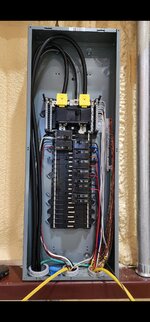

Now that I have power to the shop I'll be wiring the panel.
I did wire the two lighting circuits so I could finally have some lights.
What is your preferred method of breaker location in the panel?
Like all the 240 DP on one side, or staggered left to right?
SP breakers on one side or staggered left and right.
I know the electricity don't care just trying to figure what looks better / neater.
I was kind of thinking all the circuits that come from the right side into the panel to keep those on the right and the left on the left.
How do yall wire yours?

doesnt matter what side of the panel you put breakers because the bus stabs alternate phase to phase in each space
but one thing you do want to watch for is stacking high current breakers on top of each other. like double 30s or 50s which can build up heat.
Also avoiding across from each other as they are sharing the same stab.
Makes sense. Didn't think about that.

My electrician says he puts all of the 240V breakers up closest to the main so as to minimize drop across the length of the bus. Seems reasonable to me as I had asked as to why they were always closest to the main.
Yes checking the bus stab rating is prudent.

I start at the bottom and work my way up. I find it's easier to get it looking decent when not having to cross wires that have been landed on a breaker already. Of course, I use Square D and they found it beneficial to leave the top two knockouts open so if I don't have a full panel I am either slapping ko fillers in or sacrificing a couple of breakers for spares (this isn't an issue if it's bottom fed). I will also try to keep the high current breakers towards the top with a single pole between them

I start at the bottom and work my way up. I find it's easier to get it looking decent when not having to cross wires that have been landed on a breaker already. ... I will also try to keep the high current breakers towards the top with a single pole between them
Sounds like solid hard earned advice.
For the second part, I'll add for those not familiar, heat can soak from heavily used breakers to their neighbors. Putting two air conditioner (or heater) breakers next to each other for example can lead to nuisance trips if they're pushing their limits.

You might want a ground bar on the left side. It keeps the grounds with the circuit conductors, and reduces the tangle of ground wires on the right
You could have flipped the panel and put the main on the bottom. Then you wouldn't have the feeder wires filling up the gutter.

Yes I may end up putting another grounding bar on the left when I start wiring that side of the shop.
But yeah those feeders are a bit in the way for that.
I thought about flipping the panel with the main on bottom but a couple reasons I didn't.
1. 4/0 in that short of a distance would **** to terminate.
2. All my branch circuits come from the bottom and seemed it would be too congested.
3. I like having extra length on the feeders. In case something ever happened and needed to reterminate them. Possibly could do that up top or worst case flip the panel over then.

When you start landing circuits on the left side, put the neutrals in the rear bar first. It's a real pita trying to land neutrals on the rear neutral bar after the front bar is filled up. If SQ D would pull their heads out of their keister and make a bar than ran the length of the breakers like everyone else does it wouldn't be an issue.

Yes that would be a pain.
However the 6 circuits for the outlets that I will put on the left will share a neutral just like I did for the 1AB, 2AB, and 3AB circuits. There will also be a few dedicated 240 circuits ( no neutral) for the welder, table saw, and air compressor and probably something else I'm forgetting.
I should have plenty of neutral spaces on the front bar. But yes it would be better if SqD just put a longer bar instead of stacked like they do.
But it does keep it a little more tidy in one spot than a long bar. Idk. I don't wire panels all the time (never really) except every 10 years. Lol.
I possibly could run out of grounding bar spaces though being that this is a subpanel. But I'll cross that bridge then.
I tried to do like yall were talking about and space out the high load circuits. Seems like it will work out well that way.
