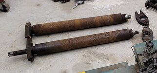

Started working on the planer this weekend after a bit of a hiatus. I ended up pulling the yoke, cutterhead/blocks and table rollers. A couple of the table roller bearings were bad so I ordered new bearings for all four rollers, and some new snap rings since I seem to be missing five of them from the factory.
20240803_090845.jpg20240803_165658.jpg20240803_170243.jpg20240803_214835.jpg20240804_123448.jpg20240804_122940.jpg
This was definitely welded and new keyway machined. Oddly it wasn't turned it seems to have been hacked with a angle grinder. The shaft should have been 25mm 6205 bearing (bearing seat was 75% intact so i left it) beyond the seat was ground off center. It cleaned up at .962" and finished at .950" for a .025" sleeve for a 1" bore sprocket. Hopefully it works how I envisioned

And after getting the infeed almost installed I realized why that side was missing most of the retaining rings from the factory. It's currently locked up tight because the roller bearing journals don't have clearance to the shoulders and the overall length shoulder to shoulder is too long by at least 1/8". Looked like I'm pulling it and machining some clearance.

Fixed the clearance issue. I took .100" off each shoulder (retaining clips were 2mm) ans reinstalled the roller. Everything works as it should now, unlike how it left the factory.

I decided to match the original sprocket retention method and thread the outfeed roller shaft. Left hand .950"x 24tpi because I was lazy and didn't want to swap change gears to cut metric threads.

Turned a bushing for the previous owners replacement attempt using a incorrect 1" bore (original was 25mm) sprocket and welded it in place. Boring it back out to .951 to match the outfeed roller. I'll cut the keyway last.
