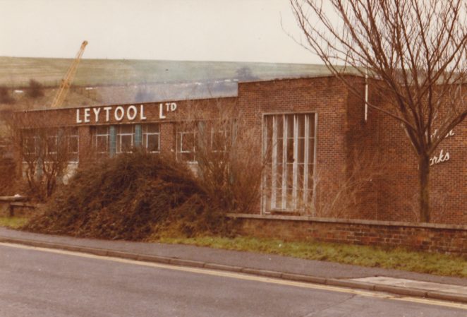

Ahh, products of the old Leytonstone Jig and Tool Company!
Originally a London firm, they primarily made jigs and dies for the aircraft industry, but also some machinery, such as slotting machines. They did work for Handley Page, who were only just up the road, and De Havilland, for the same reason.
Hand tools were another venture, and they were well known for their compact Leytool hand drill, as well as their ratcheting wrenches. Those ratchet and socket sets, with their relatively unique (for the time) hex bits, are relatively rare though.
The company moved to Brighton after the war, but the factory was closed and demolished in the mid 80’s. I can remember it going.
Much like “Charlie and the Chocolate Factory”, however, the tools continued to be available. I saw new, British made, Leytool ratcheting wrenches not five years ago, on a dealers rack. Made where, and by who, we may never know…!

Here is a link to some history
Ahh yes, that’s the place.
I can’t help but agree with the author when he says that demolishing a building after just 36 years doesn’t seem like a very good use of resources!
