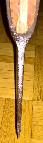

That is a unique ax for sure and agree it is a European design. How long is the cutting edge? What did the handle look like? It could easily be early 1900's. If it isn't a battle axe (heads would roll if you swung one of those) it was a serious hewing tool. The way it throws a shadow on the hardwood floor makes me wonder if it fits the term "broadaxe" by North American standards. NA standards call for a completely flat side. The handles are steamed so they lift up and away from the plane of the flat side so your hands clear the side of the log you are hewing. Here are some typical NA style broadaxes. You can see they are completely flat on one side and you can see how the handles bend upward.BroadAxeMed5272.jpgBroadAxeMed5266.jpg
13,309
Are you seeing a shadow or the bevel? I swear I see a bit of damage at the top edge that makes me think bevel. But yeah, not your normal axe, bearded by some definition I think.
none of my hewing hatchets have bent sideways handles, so bummed, that would be quite cool.
2oolhound
Dec 18, 2010
5,918
BC Canada
I'm seeing a shadow on the wood floor which makes me think the bottom can't be flat. My flat sided hatchets have straight handles also, it was just the broad axes that could cause some damage to your hands with wild swings that prompted the bent handles. They are sold like that.
13,309
Hmm, better screen says maybe you are right. Bevel is showing up now, faintly, and thus the shadow isn’t bevel, can see the damage in the bevel and shadow.
N
Oct 10, 2021
13
yeah, somehow my phone makes the bevel black
it had a straight handle, about 17" long
the bevel is about 8.5" long, it has a double bevel and no flat side
I guess the head weighs about 3 pounds, but that's just a guess.

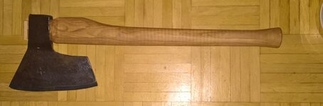

I have experimented a bit with the handle
I fittet one with the length it had, but it seems way too heavy for one handed use, a 24" handle appears to be better
I might take it for a spin at our house in the countryside and then just hang it on the wall, and for that it just seems more appealing as is
apperantly the "restore or not" is a sensitive topic
but I think it's just like religeon, it's fine to have your own oppinion about it, but you should't make any claims as to what is right or wrong for the collective.
anyways...looks like the maker is gonna stay anonymous for a while, maybe for ever
curiosity is a hell of a drug tho
so here's some more pictures of the profile and with handle
I left the wedge proud so I can swap or remove the handle if I feel like it :D

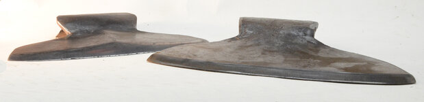

There are collectors and there are users. I think collectors may pay more dollars for something than a user but I can tell you as a user who's been collecting and using these types of tools since the early 70's I restore mine to the bright shiny look they had when they were 1st made. Try slicing through wood with a rusty axe. It will dirty your wooden project too.
I'd love to have that axe Nathan but I'd shine it up and want to cut some wood with it. And another thing I love my axes more than any collector.
I just read 5 pages in the "Show Your Bridgeport" thread and after seeing the amount of research and dedication the various collectors put into what they do I owe an apology for that statement I've just crossed out. I should never have made a comparison in the 1st place so, sorry all you collectors, you're doing an amazing job keeping these tools, their uses and their history alive. I applaud you!
The broad axes in the photos I posted above were mine when I built log buildings in the 70's. I painted them out of desperation as other log builders would try to steal them so it was my way of identifying them. (I had to remove it though because it smeared off on the logs). I eventually just dipped the end of the handle in a gallon can of paint to make this type of tool identifiable and kept a close eye on them.
Thanks for those last photos, I'm jealous ;).
