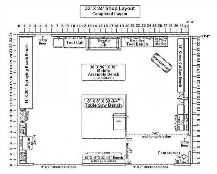

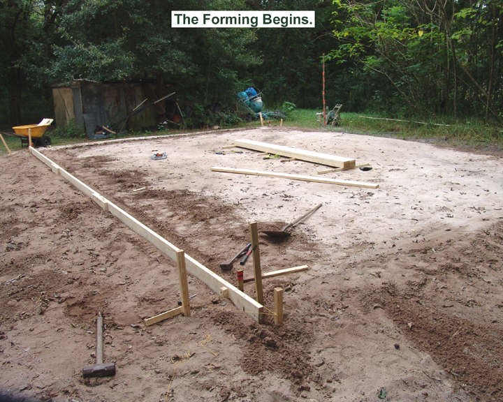

Having read this forum as a visitor for awhile now, and deciding to build another garage on my property, I figured it was time to register so I can post and share some of the experience with others.
Having completely overwhelmed my existing 22' X 36' detached garage / workshop with to many tools to be able to keep organized, I decided to build a second garage / workshop. Laying this one out to accommodate the tools I use most in a more practical way, with the ability to convert from woodworking to automotive projects with minimal effort.
The layout more or less dictated the buildings dimensions and I ended up deciding on a 32' wide by 24' deep building. The 32' wide with (2) 9' wide roll up doors will give me the 8' space between the doors for my 8' X 8' Table Saw Bench and still give me almost 3' from the doors to the side walls to have work benches down both sides while still keeping (2) open bays available.

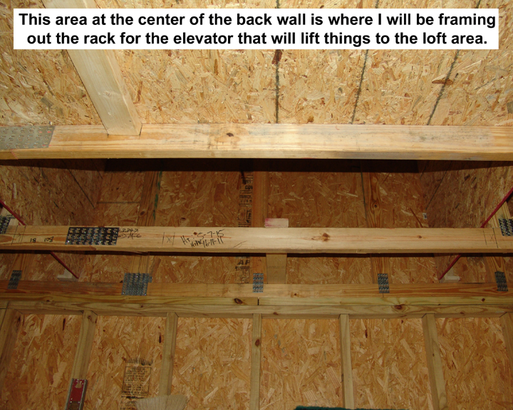

My current shop has a huge loft that with the use of a cable winch, I built a small elevator to store tools I only use occasionally like Pressure Washer, Sand Blaster, etc. upstairs out of the way. It has worked out well so I will build another in this shop to utilize the loft area above.

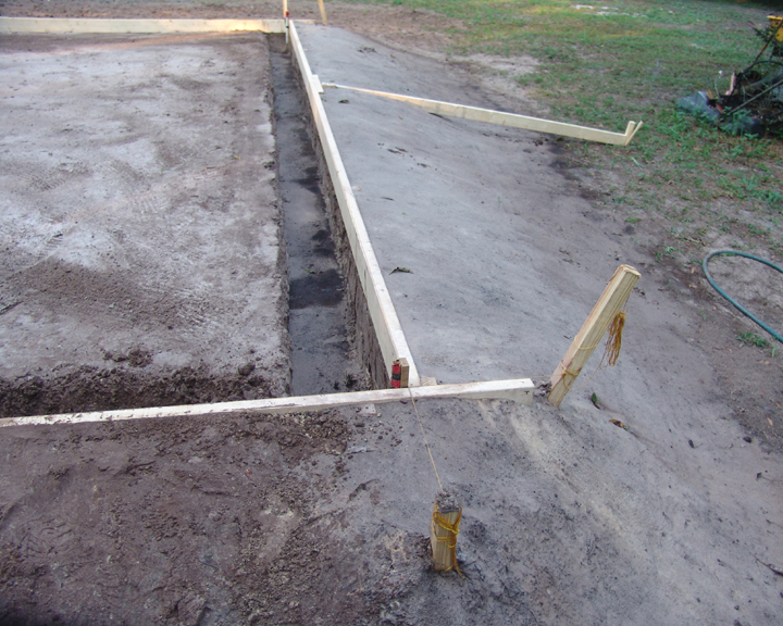

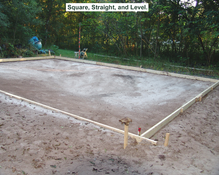

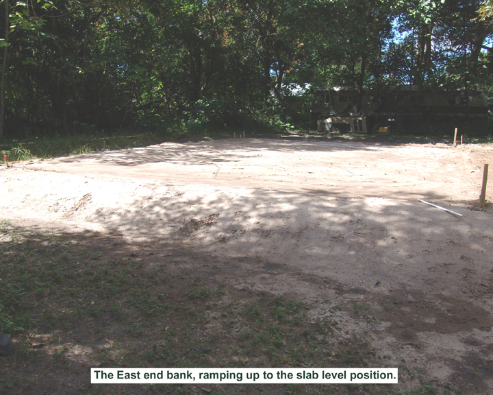

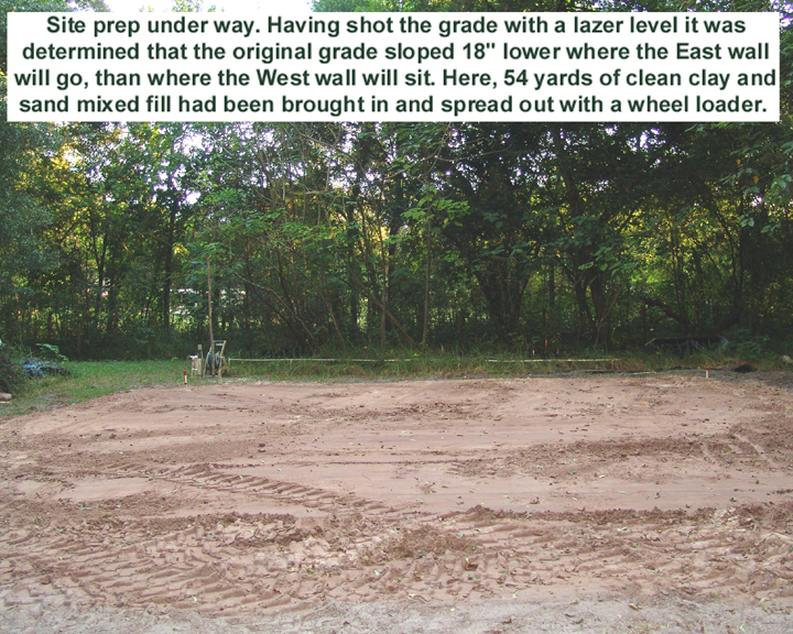

The area of my land that I decided on as the building site, took some work clearing (by hand) and was a bit more un-level than I had realized, but I was finally able to break ground (or build ground in this case) and get things under way.
Working alone doing most of the leveling with a shovel, a hard rake, and a wheelbarrow, is a bit time consuming, fortunately the fill I had brought in has excellent packing qualities and with a borrowed compactor, I finally get the grade where I want it and start forming up the foundation for a Monolithic pour.

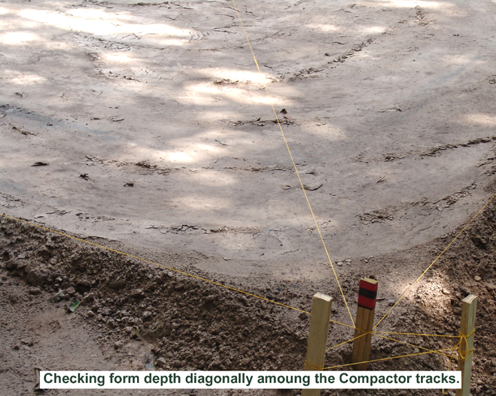

Needing to take the footers back to the original soil causes it to end up almost 24" deep on the East end.

Looks like a pretty cool layout. I think it's interesting having the big table saw bench in the middle with the idea of going between wood and auto. Is it a movable bench? I really like the cargo lift idea for the back. I have an elevator in my house and it really does make it nice transporting goods up and down floors.

No Aquaticbob, the 8' X 8' Table Saw Bench doesn't move, which is why for me having enough room for it between the two bays will be nice as opposed to how badly it hinders the layout in my current workshop. The new shop (as the layout drawing shows) is pretty much centered around it. It's placement from the walls will allow me to rip 12' long stock, and still cross cut an inch (or less) off of 4' X 8' sheet stock.
The Table Saw that the Bench wraps around is the 5 HP industrial version of the Rockwell Unisaw with a Biesemeyer T-Square Fence system that extends 50" to the Right of the blade and 12" to the Left of it.
The Table Saw Bench is framed of 2" X 4", Decked in 1" MDF, and Laminated with Wilsonart white satin mica. At 8' X 8' it's large enough to accomidate the Table Saw, with it's own Dust collector unit, and still have room to slide 4' by 8' stock under it as a material rack. The 110 VAC recepticals wired into all four sides, as well as the 220 VAC saw and dust collector, will be fed from the service panel via NM conduit ran under the slab and surfacing under the Saw Bench.
So all in all, it is very stationary indeed.

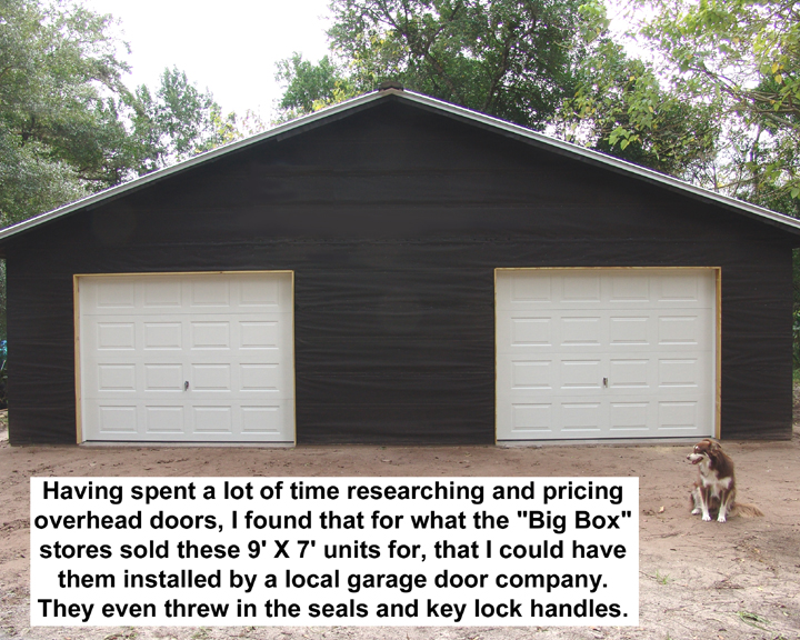

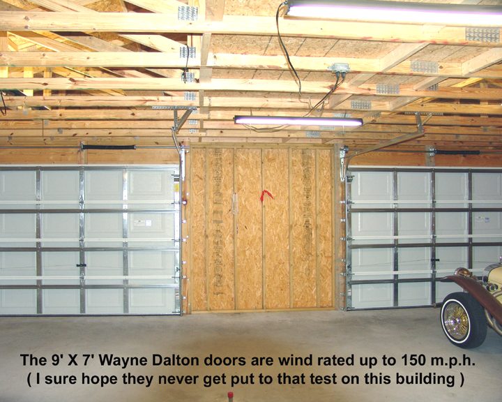

Pretty much the same thing with the doors. The 9' wides are just very common around here, and I am hoping to find a nice nearly new used pair. I was seeing them on Craig's List locally, (until I needed a pair that is) although I think they were people parting out their houses they were getting foreclosed on.

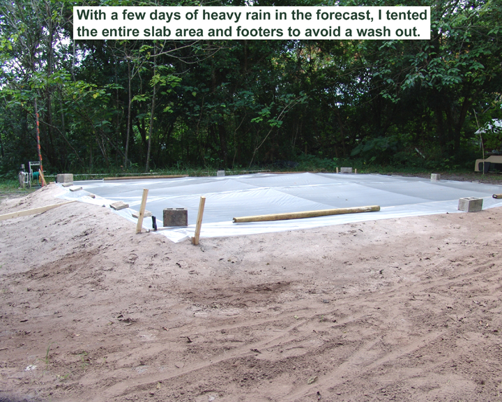

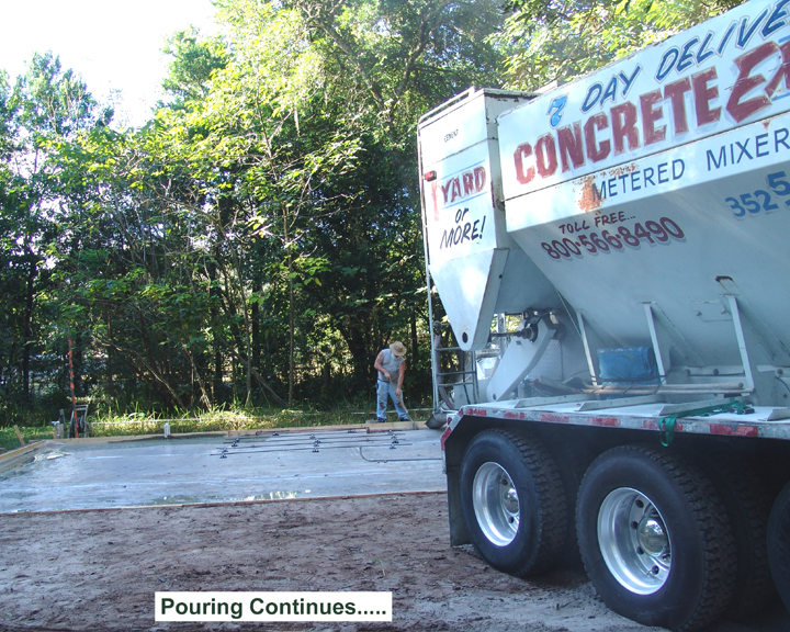

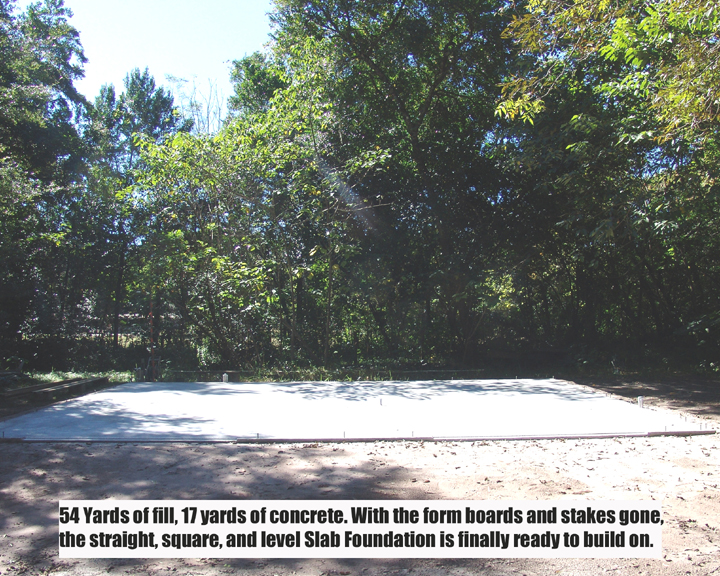

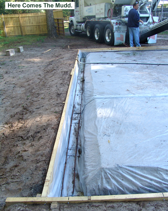

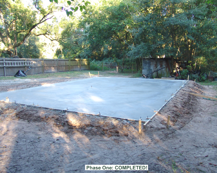

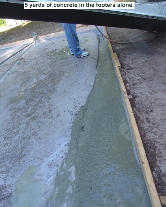

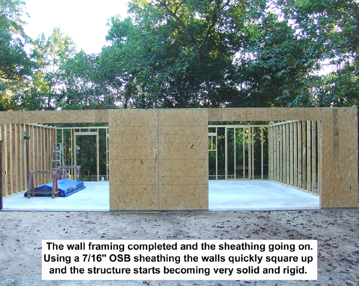

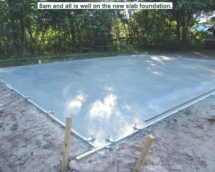

Well, with the ground inside the forms treated and the barrier down, the Re-bar all in place, and the fiber mixed into the concrete, it's finally time to cover up all that digging I've been doing.
The Footers really consume a volume of concrete.
Time to start making Vertical progress

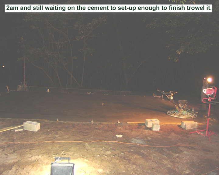

2 AM for the last post.......I've been there....woke up yesterday at 3:30 AM thinking of a few nails I needed to drive before the OSB goes up on my build. Compressor and gun in hand by 4 AM...then off to work at 7 AM.

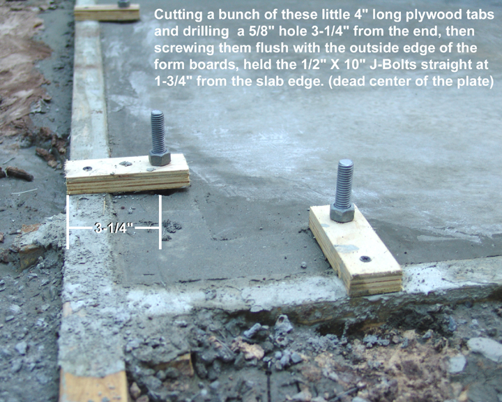

Thanks for the update, I like the way you held in the plate bolts. Nice work it's always nice to have a nice flat surface to work from.
That picture of waiting for concrete to cure brought back memory's. Seems I remember sending the wife to pick up some work lights to finish the slab. Ron

I agree 55 carman and those little plywood tabs worked well at holding the J-Bolts right at dead center of the bottom plate too.

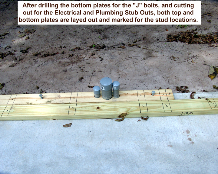

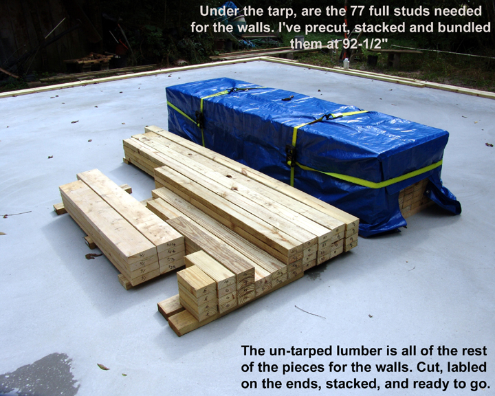

Setting up beside the slab
Laying out the wall plates
Prep work

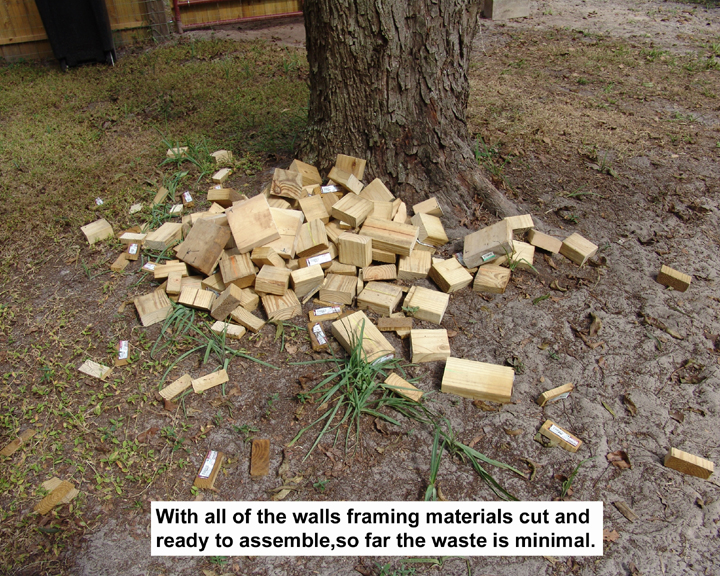

Maximum material yield.

Very impressive. I like how you precut everything. Hats off to the minimal waste. I would have had at least one or two almost full boards from some errors in that pile.

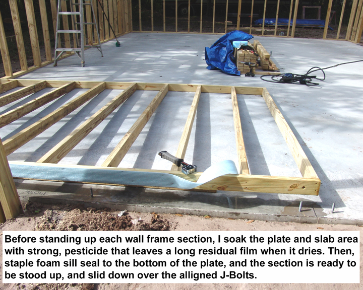

Another big problem in this area are the Subterranean Termites. If you lay a piece of white wood on the ground here, odds are it will be gone in a month or two. They are like little Parana just under the ground surface, just waiting.
Treating the ground just before applying the vapor barrier before pouring the slab helps, but also I am using Pressure Treated lumber for all of the wall framing as well.

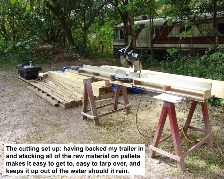

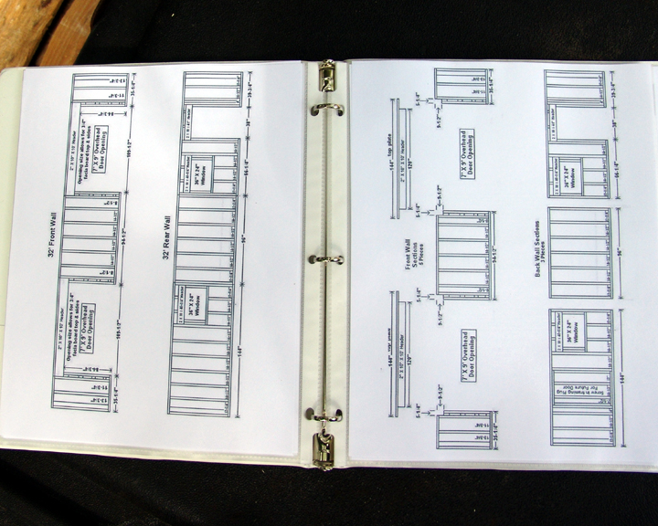

"Preliminary Planning for Optimization"

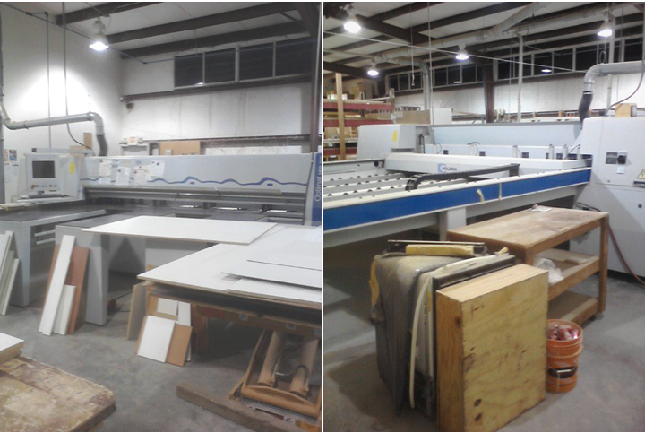

Here is a little tip for anyone with very little carpentry experience contemplating their first build. While common sense, or un-nessasary to the more experienced of this forum, hopefully helpful to someone.
After years of working as a Project Manager and then General Manager of a very large Cabinet Manufacturing Company that produced Custom Cabinetry on a Production Shop basis, I got in the habit of producing 2D shop drawings that left very little for the crew to figure on their own. It eliminated any lack of communication, and also gave me accurate material ordering abilities.
Whats more, with the type of equipment we ran at this shop, from the computer in my office, I could tap into the Saw's "brain", and send it a cut list.
In the blink of an eye, it would not only set itself up to cut the parts, but also send me back an "Optimization Schedule" showing me how it intended to cut the 4 X 8 panels to get the least fall off,(waste) and how many panels it would take to complete the list. Asking if I had a better cut plan and waiting for a confirmation.
Try as I might, in all those years I never did beat it's optimization plan but, I did develop the ability to look at a cut list and visualize how to get the parts from the least amount of material.

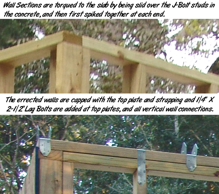

The biggest trick is to cut out the entire job first. In framing up a building, arrange the cut list by length (longest to shortest). Pre-cutting all your materials allows you to cut all your longest pieces first (using the straightest lumber) then using the fall-off (and warped lumber) for the shorter pieces.
Aside from the optimizational benefits, once you get the framing gun in your hand, your already done with the chop saw and you don't have to bounce yourself back and forth between tools wearing yourself out and making wrong cuts because the number you just measured somehow got mutated in
your head on your way to the saw. (come on guys, you've done it and you know it)

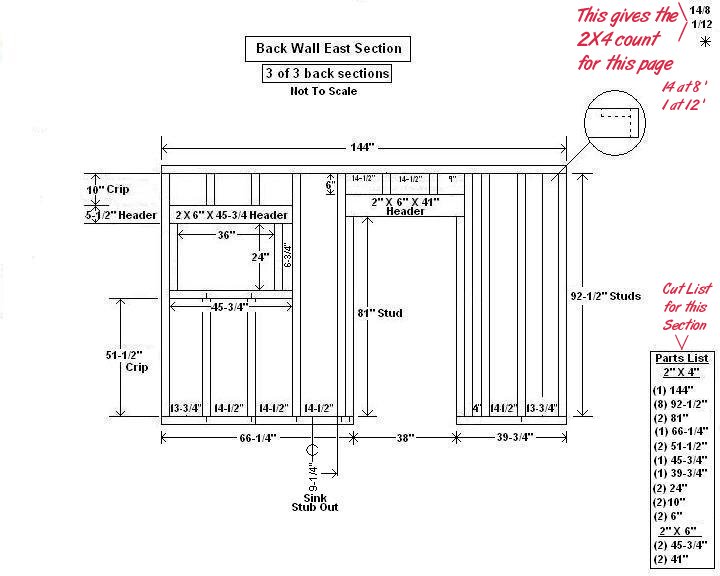

Although I am fluent with CAD based softwares (like 20/20) which are great for modular cabs with nominal sizes, laying out custom cabs with them requires changing parameters at the set up level, and becomes very cumbersome. Not needing 3D capabilities for shop drawings I found that the simple "Paint" application that comes with "Windows" was sufficient and quick for 2D stuff. So, to give myself an accurate materials list, and cut list for this Garage project, I did the layout and made similar "shop drawings" with the "Windows" "Paint" application. Each section of the framing got a "shop drawing" like this:
Combined, the numbers at the upper right corner of the pages produce the complete material list to frame the building, and the numbers at the lower right corner of the pages produce the complete cut list. (Note that the cut list is arranged by longest to shortest)
Hopefully someone might find something beneficial in all that rambling, but now, back to the build.

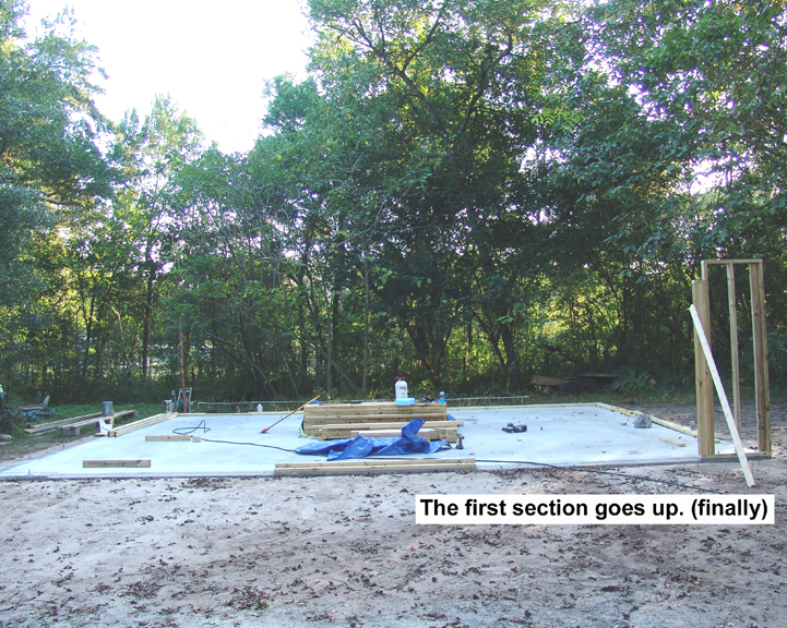

"Vertical Progress"(or....up we go!)

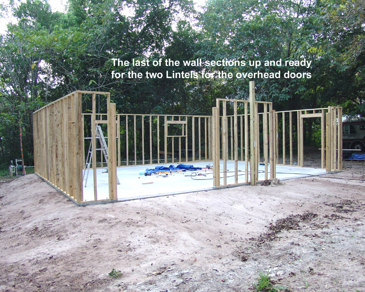

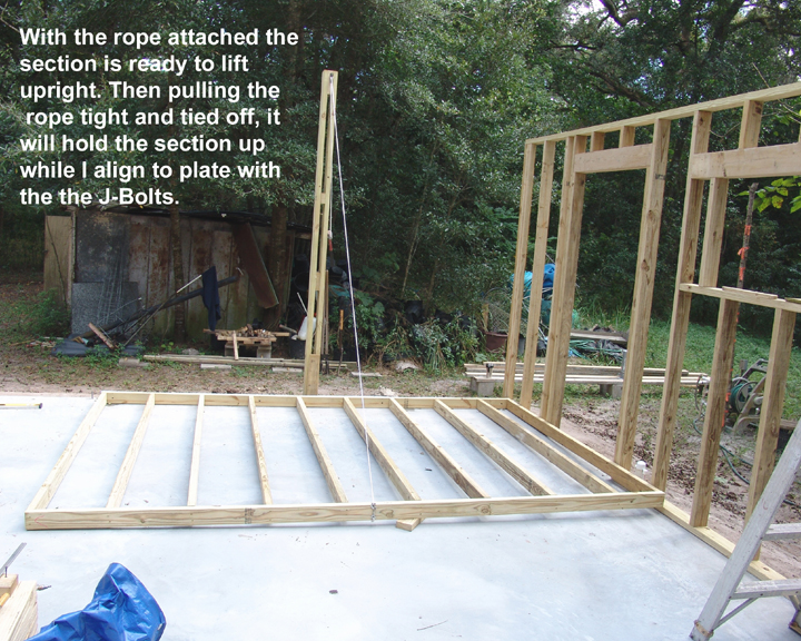

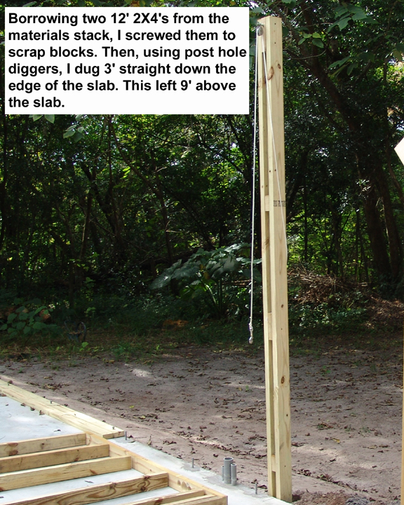

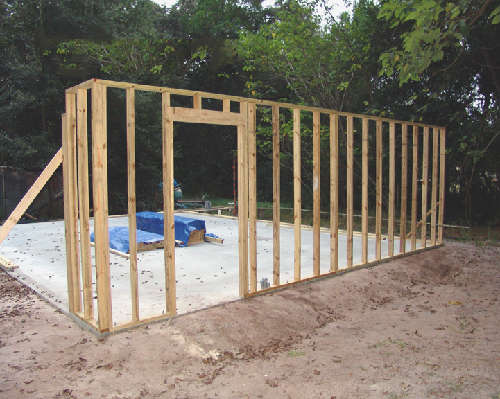

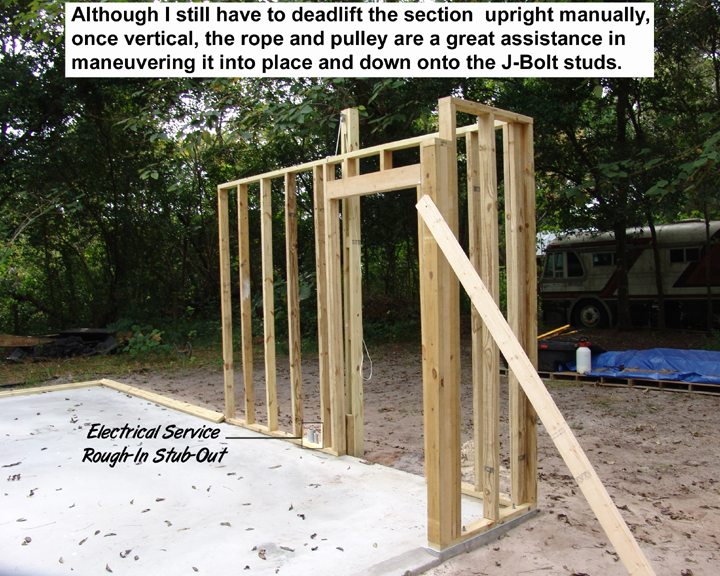

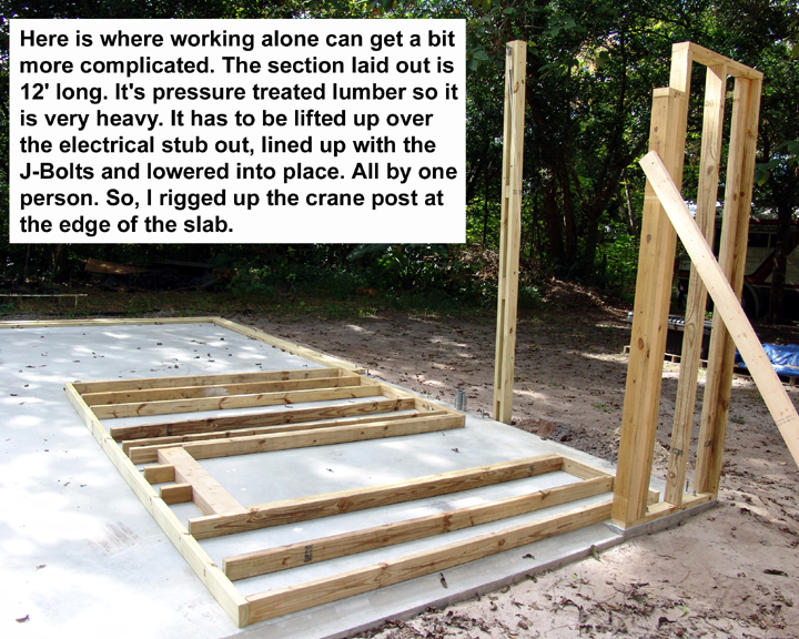

Here is one of the many (countless) ways I end up compensating for taking on projects like this alone, without help.
The West 24' wall up in (2) 12' sections
Onward with the Upward!
One Guy, One Afternoon, One Wet Heavy stack of PT 2X4s gone Vertical!
And to all......a Good Night!

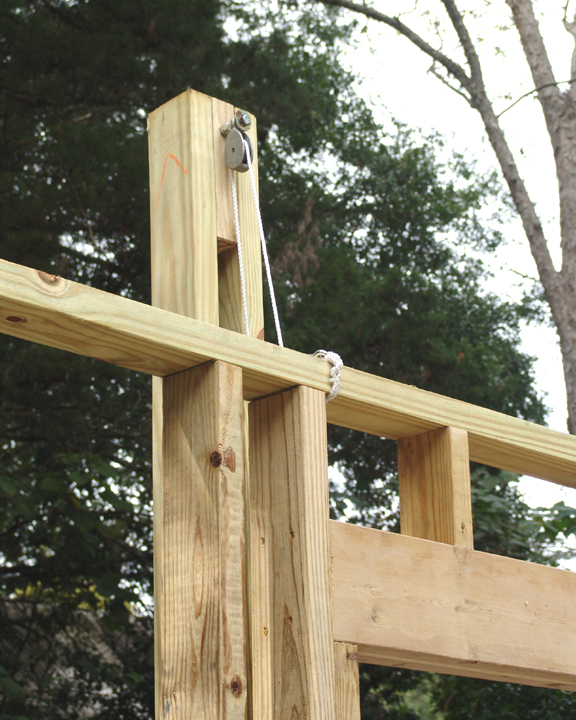

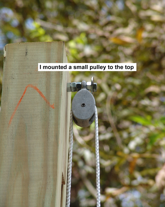

Interested in seeing your trick for single handily putting up roof trusses.:dunno:
Actually, I'm always rigging up some kind of third hand myself. With a little forethought and ingenuity one man working alone can accomplish a lot. My hat is off to you.:thumbup:

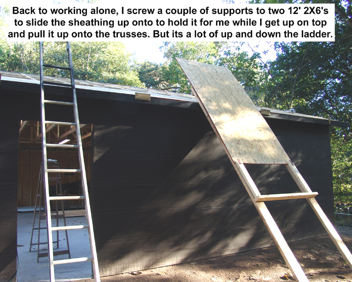

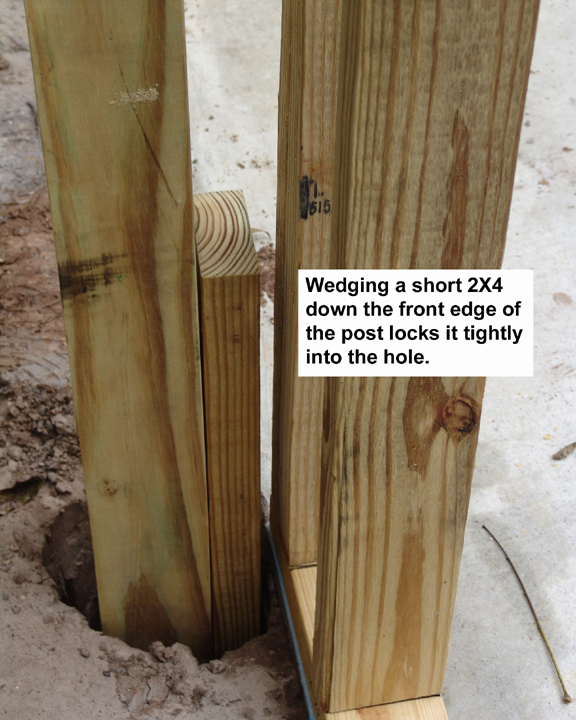

Actually Bib Overalls, as a rule I rarely use trusses, and prefer laying out rafters. However this build is an exception. Because I want to utilize the loft area, I opted for running the gables the 32' span, with a 6' wide loft running the 24'depth. With the 32' being a clear span inside the shop, trusses were the more logical solution this time out.
The last time I used trusses however, I actually did set them alone. After screwing 2X6s on edge, vertically to the outside of the wall that extended 5' above the top plate to hold the gable truss up for me, I have a panel hoist that I strapped a truss to and brought it up diagonally inside of the building. However, I had to lean them against the gable truss to maintain enough room diagonally to bring the next one up. All and all, it was a very time consuming task, but I was able to single handedly set the trusses.
As the saying goes, Necessity is the Mother of Invention. (or was that Desperation is the Mother?)
Yes SARG, let me Clarify that for you. I am using pressure treated in all the framing for the walls. And Yes, Subterranean Termites are the issue. They are relentless here. They will come out of the ground at the edge of a slab and make little tube tunnels (that they travel inside of but are very hard to see) right up the slab bypassing the bottom plate (being PT) and destroy half the untreated studs by the time you realize they are there.
There are basically two choices around here. Either pay 8 hundred to a thousand dollars a year for continuous yearly treatments, or frame with PT.

Just curious...hard to tell but did the double top plate get attached after the walls were stood?
Z
zappman
Dec 22, 2013
57
West Central Florida
No and Yes Ch3No2.
No, a "double top plate" didn't get attached after the walls were stood, but
Yes, a single top plate was attached after the walls were stood (staggering the wall section vertical connection joints, and pulling them straight and rigid) which when added to the wall's existing single top plate, created a "double" top plate.
Actually I am sure that's what you meant, but when I read the question I had this image of standing up a wall section with no top plate (studs splaying in all directions) and having two 2X4s nailed together in the other hand.

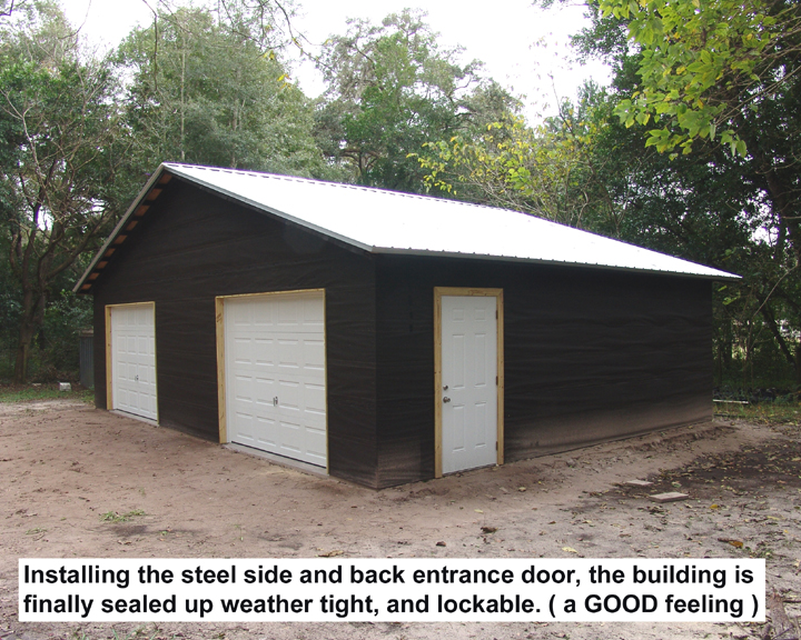

On with the Update.
Dirty Harry once said "A man's got to know his limitations". Well, I haven't come to terms with mine yet, but I think I found my truck's.

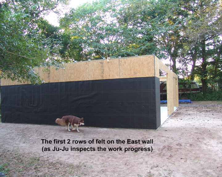

Having read to much about the down side to Tyvek and similar house wrap products, I decided as usual to stick with the old school ways of my Grandfather, and go with #30 felt.
Growing up, I thought it was really the siding on Grandpa's "Black House".
And it's a good thing too, because:
Now, when your used to working alone, and you know your buddy is going to bring over his GradeAll with an insane lifting capacity to help you get your 34' long trusses up onto your building, it tends to give you ideas that can make things easier yet.
Now as long as the good weather holds awhile longer. I've been fortunate with very few rainy days so far during this build. (Knock on Wood)

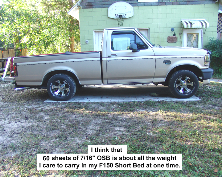

Nice build zappman, the old f-truck didn't look to happy about the load. This is how i had to pick up my timber until i bought a pickup, it took 6 trips for 1 pack of timber.

Thanks 80WTI_55_CHEV. The old f-truck didn't act to happy about the load either but it brought it home. :3gears:
I don't usually work it very hard, but it is a truck.
I can't beleive you crammed two dozen 2X4s through the window into the interior of a 55 Chevy Show Car. "What was ya thinkin' Mate?" and not once, but six times as well? Good to know you bought a pickup though, and won't have to treat the Chevy that way again.

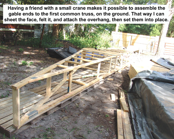

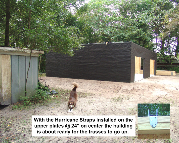

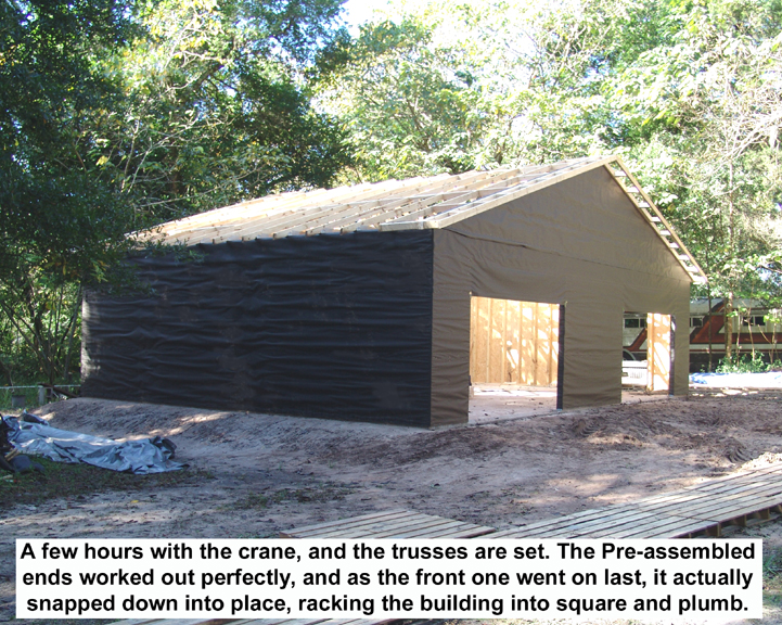

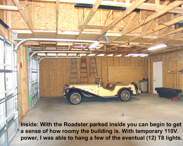

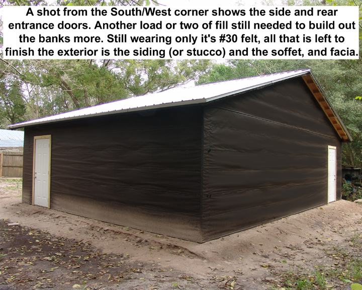

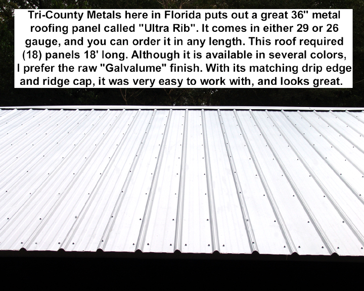

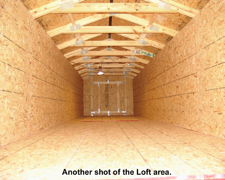

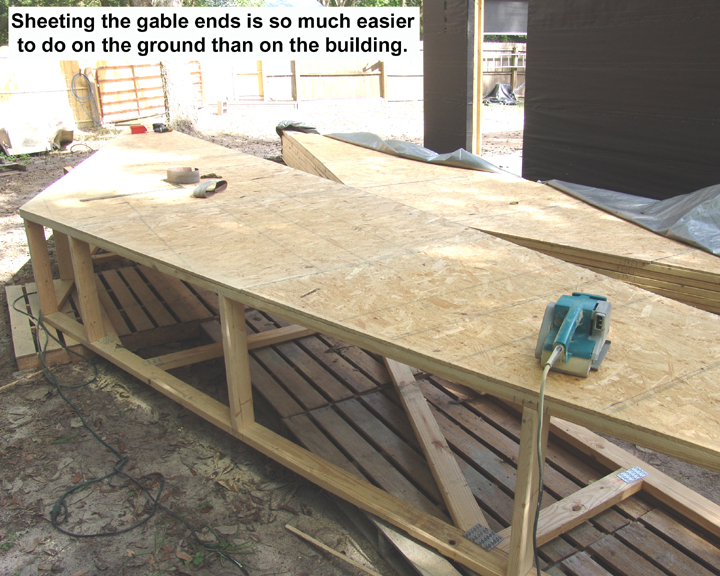

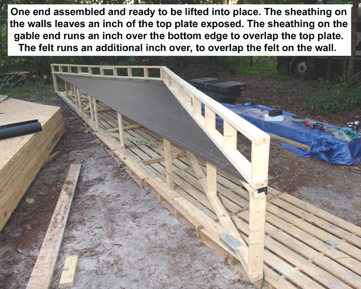

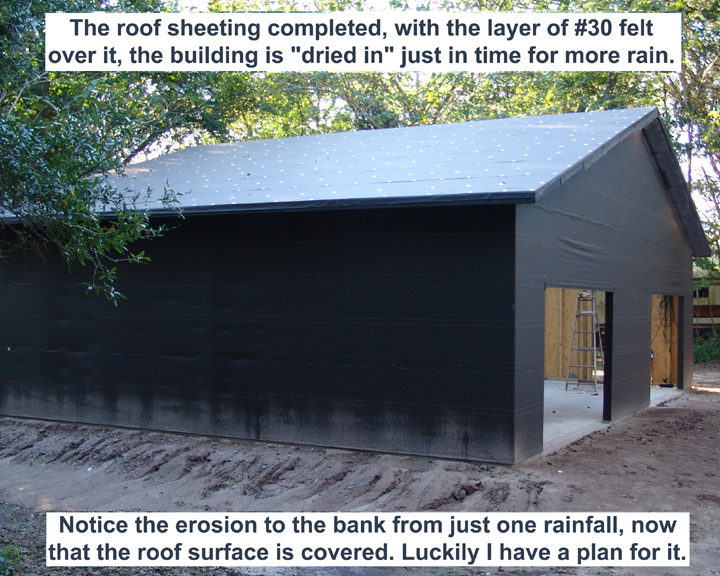

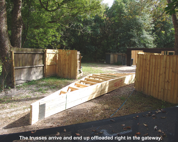

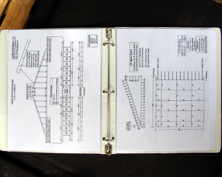

I thought I'd post a few update pics of the build.
I can't say enough about what a hassle saver pre-assembling the gable ends with the 1st adjoining common truss was.
Having the gable ends already in sheeting, felted, and the overhang "ladders" already mounted when the gable ends went up, was sooo much easier than doing it all once they were in place.
Massive thanks to my buddy and his GradeAll telescoping boom crane.
If you are going to have your trusses lifted into place by something that can handle the weight, I highly recommend pre-assembling the ends.
Until the next update:

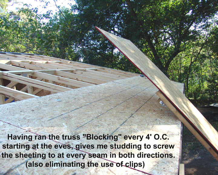

Excellent planning on your part to install blocking for your roof sheeting seams. That's the kind of little stuff that really makes a difference in how things look after a few years. Well done.

As they say MagKarl, "The difference is in the details".

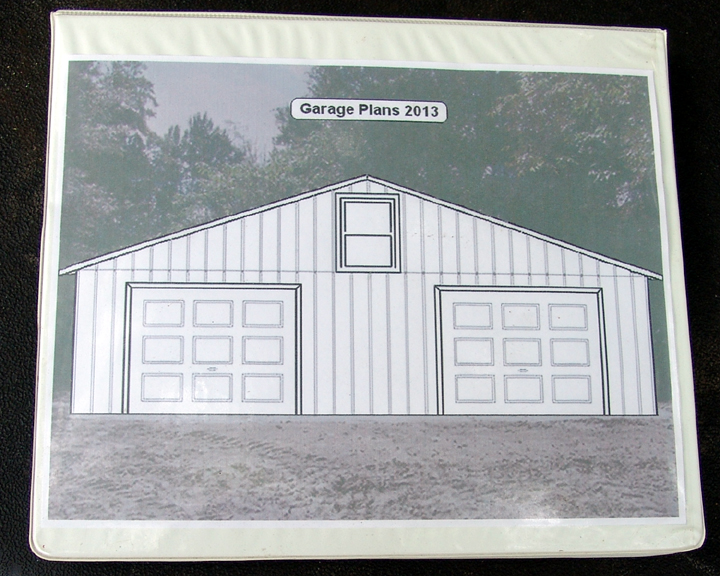

Actually, as far as the planning goes, prior to starting, I wrote "The Book" on this building.
This notebook covers the building's every phase of construction in great detail. I think it was in my 4th posting in this thread that I discussed "Preliminary Planning for Optimization". and posted a page from the "Framing" section of the book to show that each page of a section's drawing, includes not only every dimension of the section, but also a stock materials count, as well as a complete cut list for that page.
With additional drawings to show how the sections of those pages actually fit together.
Every detail and dimension drawn out, every material quantity listed.
The sections cover every phase from Foundation Forming, to final Light Fixture Placement. Covering every detail from J-Bolt placement, to Wire Routing, counting and accounting for every fastener and strap, to every inch of wire along the way.
With every cut of material pre-calculated, so far in the entire build, the amount of fall-off (waste) has only filled a standard outdoor trash can 3/4 full (and a lot of it is packaging)
Thus, the material cost has been kept to a minimum, and the labor cost has been Zero (having worked alone with a couple exceptions).
In today's economy, "Preliminary Planning for Optimization" is the only way I could have afforded the build.

Now for some update pictures:

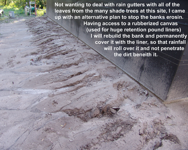

Now that I have had enough rainfall to see how the run off will flow, and what effect the elevation change for the foundation has on the rest of my land, I will be bringing in another 2 loads (32 yards) of fill to extend the East end bank, and level the approach.

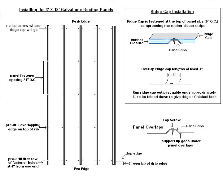

Wanting to pre-drill the panels for the fasteners, I had drawn up this product info page (again using the Windows "Paint" app) for the book. There are 940 screws (including the Ridge Cap) in the 26' X 36' of panel surface on this roof.
I spent the better part of a day just "Screwing Around", and gave my old Hitachi cordless quite a workout.
Once the roofing was completed, I immediately pushed onward to the doors, wanting to finally get the building sealed up. My research bringing me to having the over heads installed by a door company.
Having just completed the roof, my exhausted muscles welcomed the reprieve from installing the over heads myself. Taking advantage of someone else doing their install, I used the time to myself, to install the two 36" entrance doors.
Having finally gotten the building sealed up, What a good feeling turning the key in the entrance door's deadbolt was.

It turned out that I got the building closed in with perfect timing. As soon as I did, the weather turned rainy and cold. (cold by Florida standards anyways) With things closed in though, I was able to get things going inside.

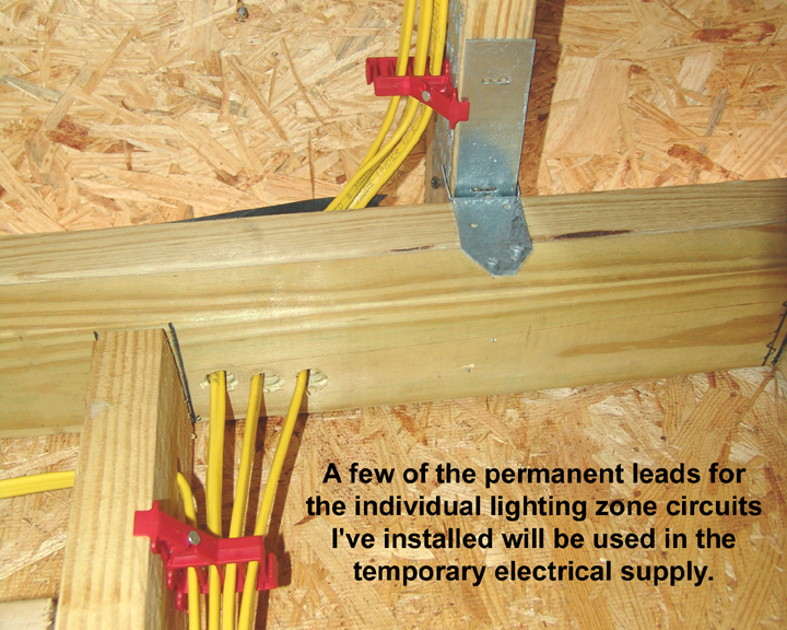

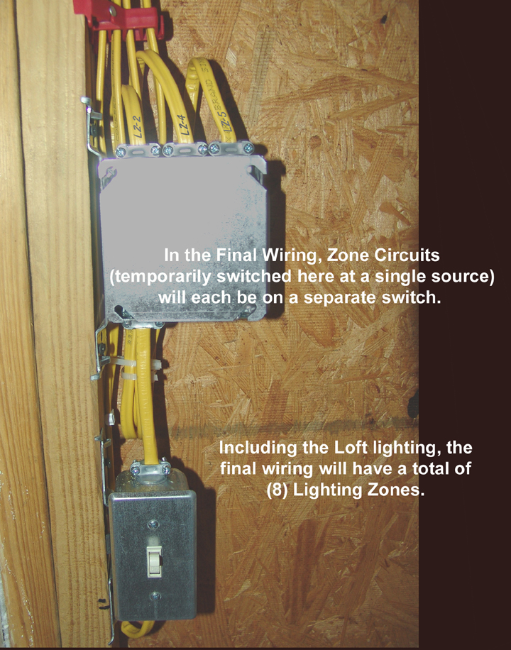

With the Temp.(phase 1 electrical) completed, a flip of the switch powers up the partial lighting. I also have a wall receptacle powered for use at each end up the shop.

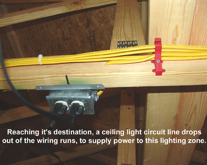

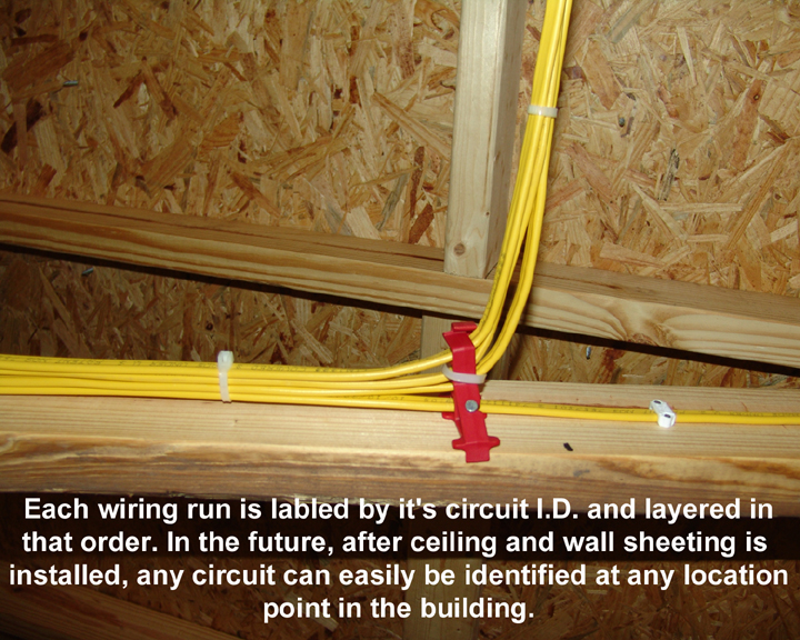

I'm not sure the thread title "Building Another Garage" does justice to this build. Very impressive work.
One question, why zip tie the romex between the multi-cable holders? Just to keep things neat?
Z
zappman
Dec 22, 2013
57
Thank you for the compliment ginslung. It's been a lot of long days so far. Working primarily alone, throughout the build has presented a few challenges, so it's been as much a test of ingenuity, as it has carpentry skills. Overall though, I am fairly pleased with the resulting product thus far.
As for the "zip ties", yes basically. As the circuits are layered in the runs across the building, after being coiled up, the romex does not want to lay flat at all. between the plastic stack holders they want to twist and hang loose. So it's a matter of starting at one end of the run and working the layers down tight and flat and keeping them that way with the zip ties.
If you look closely to the image re-posted below, at the center truss, and between the red cable stack holders, you can see how straight and cleanly (4) 20 amp circuits run across the building, tucked up tightly and safely out of the way.
