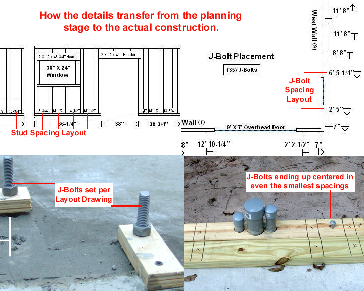

great work. I really love the project print out you made. definitely something I need to start doing.
Thanks r0yal.
"The project print out" can save you much grief in the long run. Aside from giving you an accurate materials and cut list, it can help you foresee possible problems and avoid them. If the numbers don't add up right on paper, they surely won't in the construction.

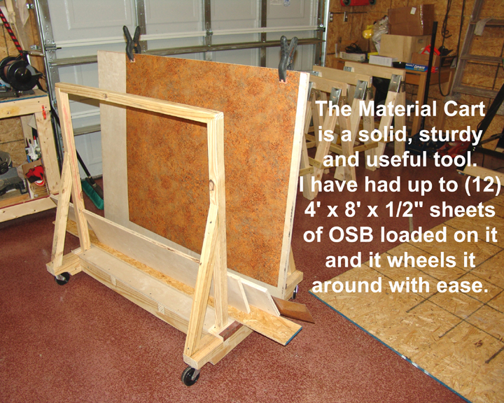

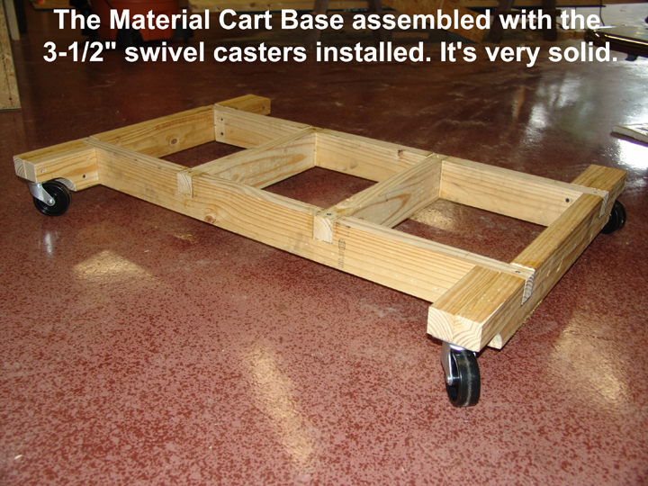

Above all, it gives you a great reference guide to go by. As illustrated in the picture below, how per-calculating effects the end result.
Personally, I'd rather do the math over a quiet cup of coffee in the evening, than on the fly with all of the possible distractions.

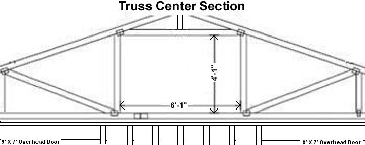

is that loft in the center of the 2 doors I had the same thought on the building I'm planning. anymore details
Yes JCQuick, The Trusses are at a 4/12 pitch I wanted to maintain at least a 4' height, so I managed to get a 6'-1" width. So the 4' X 8' decking is a sheet and a half wide on the floor and one sheet tall on the sides. The Loft is 24' deep so it actually has quite a bit of room up there.
Any other details you'd like to know about, I'll tell you what I can about it.

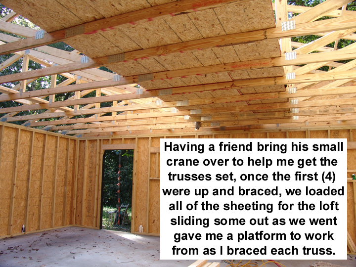

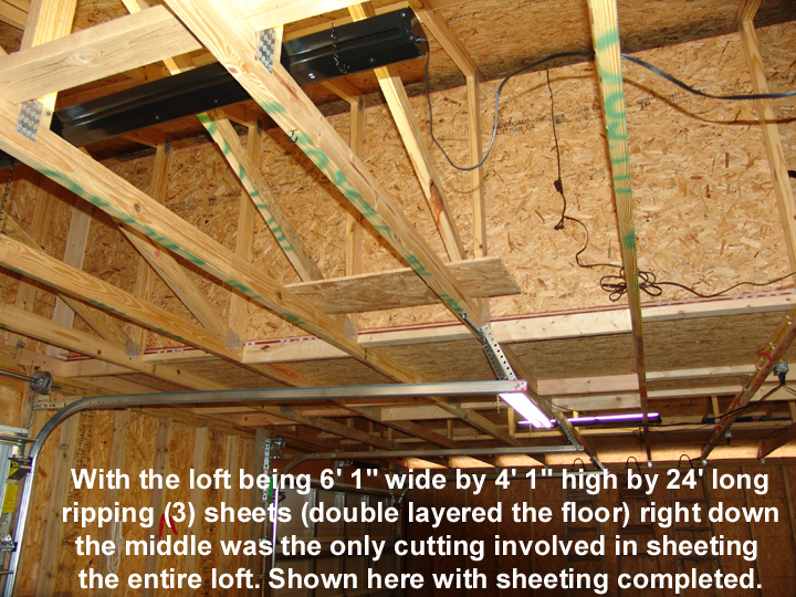

Here go JCQuick, I went back through my pictures, and here are a couple more relating to the loft area.
With the cost of 7/16" OSB being so low, I was able to double layer the floor giving a 7/8" OSB floor up there for less than sheeting it in a single layer of 1/2" plywood.

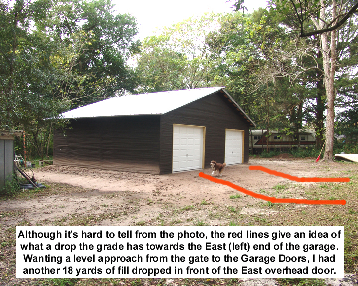

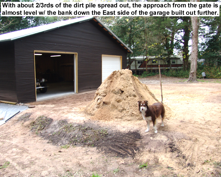

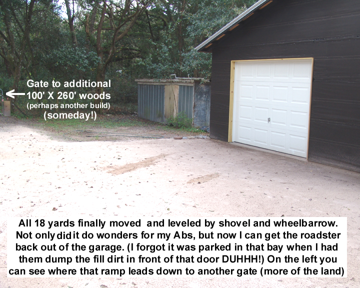

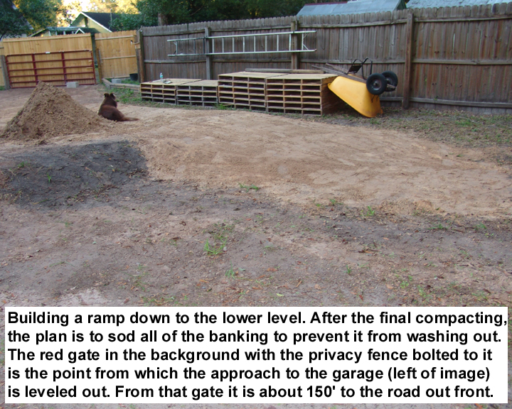

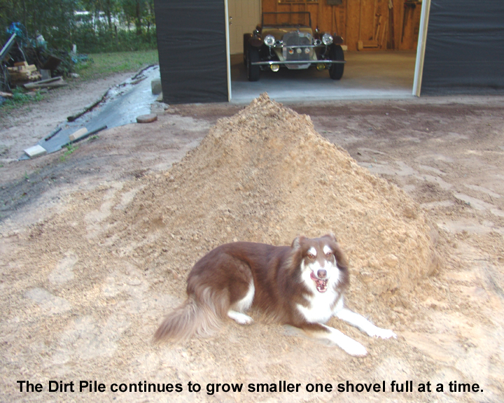

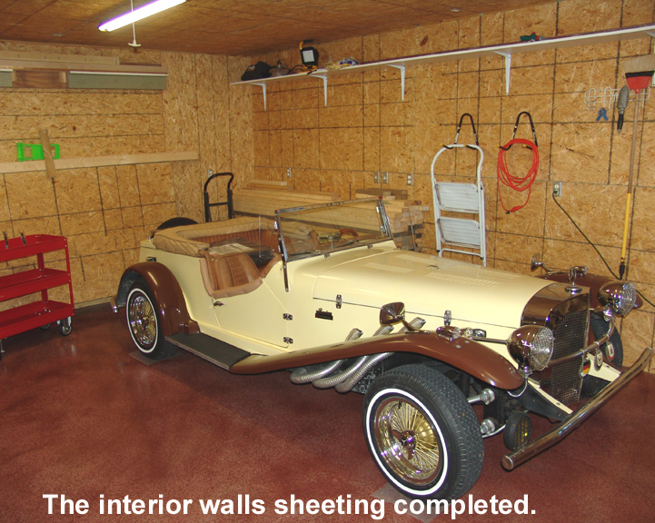

Well, its been awhile since I posted any updates. We've been getting a lot of rainy days. Between them though to level out the approach, I had another 18 yards of fill dirt brought in and dropped in front of the build. From there I slowly moved and leveled it by hand, with a shovel, a wheelbarrow, and a hard rake.
(above) before
(below) during
Above you can see how I've got the bank down the side of the garage tarped off to keep the water rushing off the roof from washing the bank back out. The tarp will be replaced with a layer of rubber retention pond liner a friend is giving me to permanently install over the bank.
And finally after much, much, shoveling, the pile is gone, and it's all ready for a final compacting. Yeah! :rocker:
Until the next update:

Regarding the tarp or pond liner..
Is it too shady to support plant material (grass, ground cover) on the bank?

Thanks getthewheelsinline, I had a Wood Shop teacher in Jr. High that used that saying a lot. I guess it must have sunk in to some extent.
No OHSCrifle, it's not to shady, and for most of the banking (like around the approach) I will just lay sod. It's just the 26' down the East end of the building that will get the rubber cover over the bank.
With that side of the building's 18' X 26' metal roof surface on a 4/12 pitch, I'm afraid the water coming off of it during some of the torrential down pours we get around here would still wash the dirt out right through the sod.
There are way to many leaves falling year round onto that area for rain gutter too. I'd spend the rest of my days cleaning them out constantly.

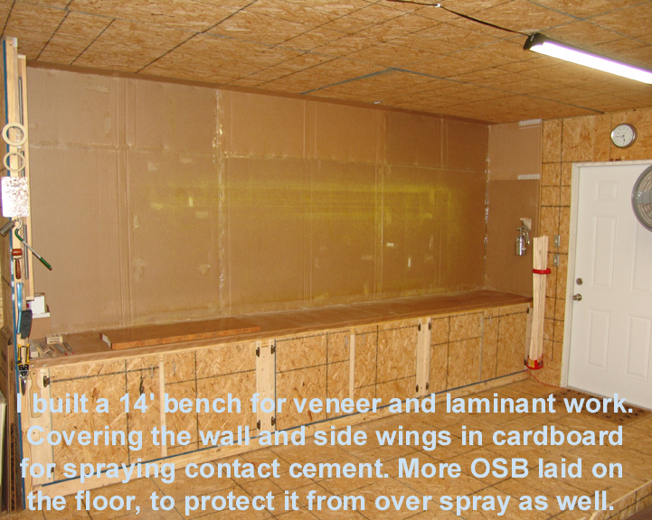

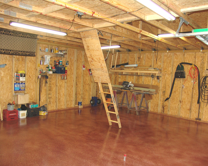

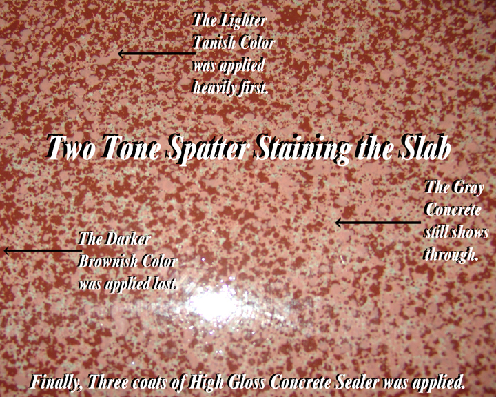

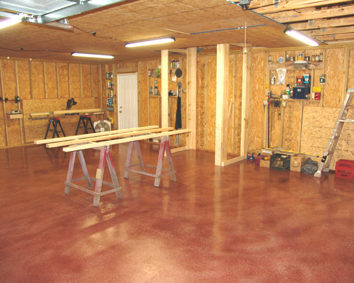

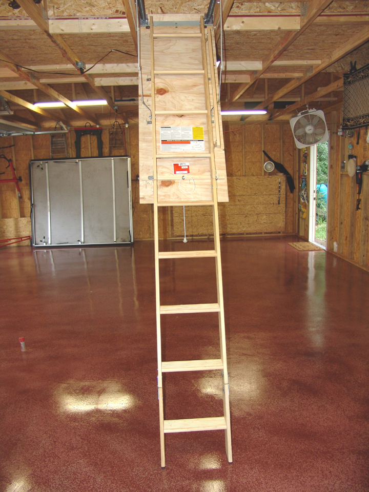

Because I will be doing a lot of wood working in this shop, I wanted a smooth sealed floor because trying to
keep fine sawdust swept up off from my existing garage's porous concrete floor has always been a pain.
So, knowing how things have a tendency to work out, I figured if I didn't do something about the bare concrete
now, I'd end up moving in benches and tools and then the floor would never end up getting done.
I opted to go with a concrete stain, and clear gloss solvent based sealer. I decided on a two toned (tan/brown)
spattered finish. The picture below shows the floor treatment I did, using a standard $20 pump up insecticide
type sprayer.
Needless to say, that with the three coats of clear gloss solvent based sealer (8 gallons total over 768 sq. ft.) I
got that smooth sealed (easy to sweep) surface I was after.

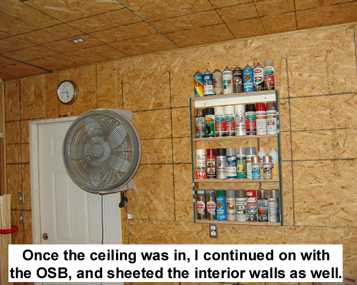

With the floor finished, I decided I wanted to get the ceiling up while there was still nothing in my way. Aside
from the elevator to the loft, I wanted simple access up and down from it. So, my next move was installing a pull
down staircase.
I mounted it between the trusses at the outside edge of the loft, so that at the top of the stairs you'd be
entering the loft from the side wall, and not taking up any of the loft's floor space with the staircase.

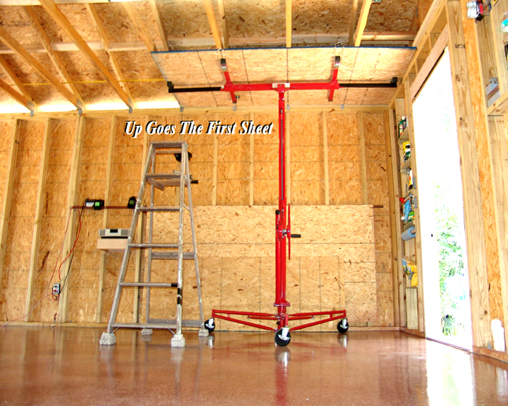

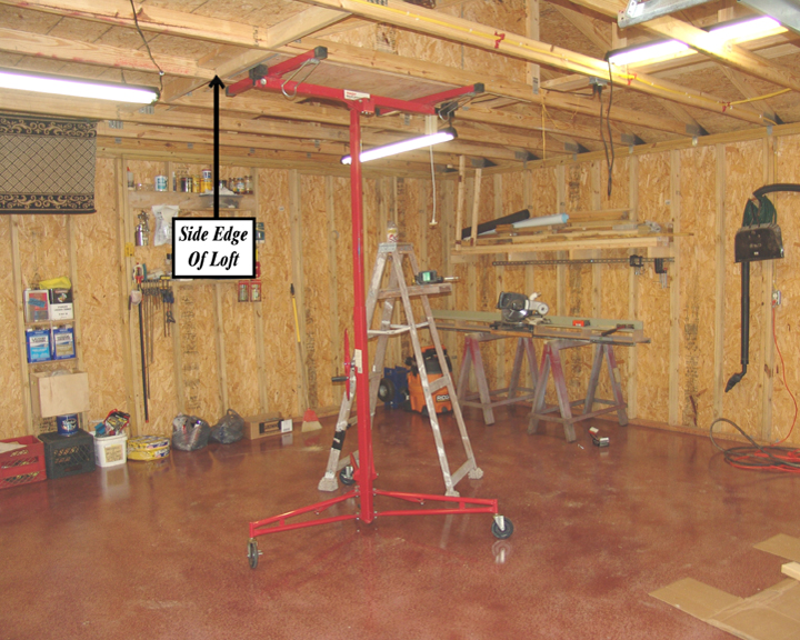

I had thought about buying one of these drywall jacks for several years. I finally did on my last project (an
addition on the house) I have to say that it is nice to have around when you need it. It certainly made installing
this pull down stair case a piece of cake to install.
With the legs cut off to size it's ready to climb.

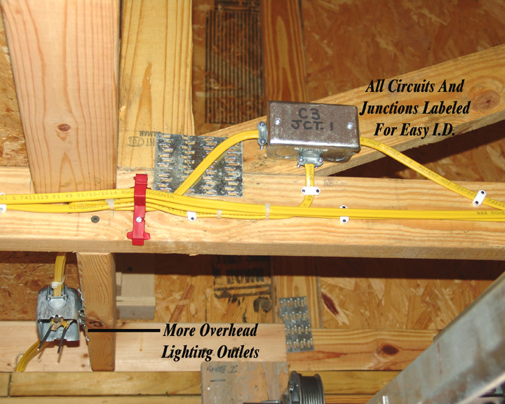

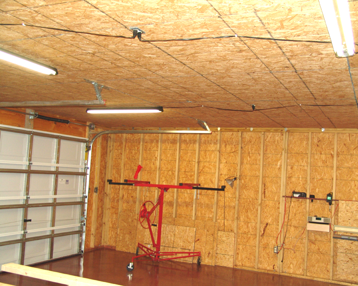

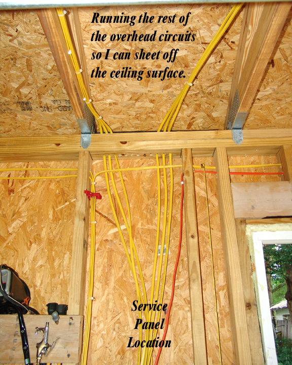

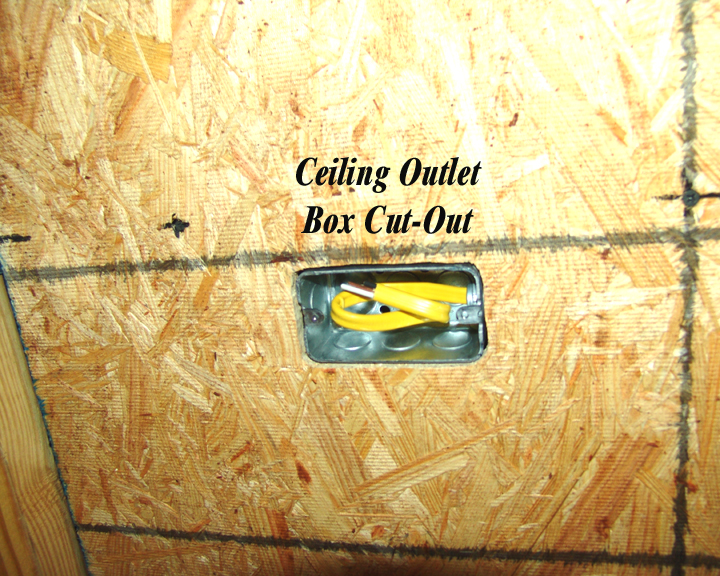

Having only ran a few of the over head electric lines (enough to run the temporary lighting) before putting up the
ceiling, I had to make sure that all of the overhead wiring was completed first.
And now with all of the overhead rough in wiring complete the real fun begins.
The drywall jack is really earning it's keep because each sheet goes up, gets any outlet boxes marked, then
comes back down to be cut out, then goes back up to be screwed to the trusses.
Slowly sheet by sheet making my way across the ceiling. As I get to it, each light or overhead door track
support has to come down and then be re-installed after that sheet goes up.

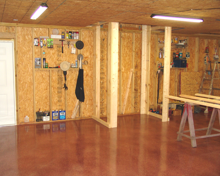

Finally, 24 sheets, 480 screws, and a lot of handling, the ceiling is in. The only opening in it now is at the elevator shaft (pictured here against the back wall). But, the Ceiling and Floor are now complete.
Well thats all for this update. I hope it won't be long till the next one, now that I am back on the project again.

I was under the impression that you couldn't bury junction boxes behind drywall.
This is America dittle fart around, we can do whatever we want here. You know, "Land of the Free" and all that.
Spot On Zeke! And even though outside of the "Loft" area, there are also access doors in the "Loft" that allow access to all of the wiring runs. So nothing is actually buried.

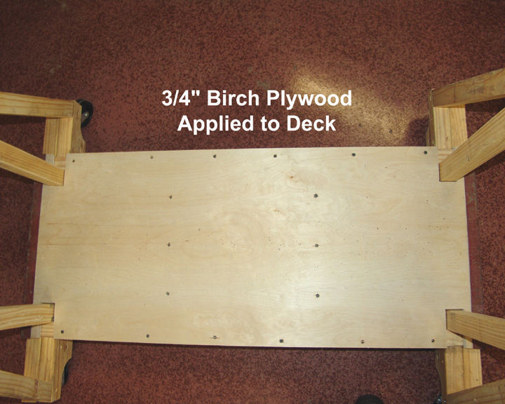

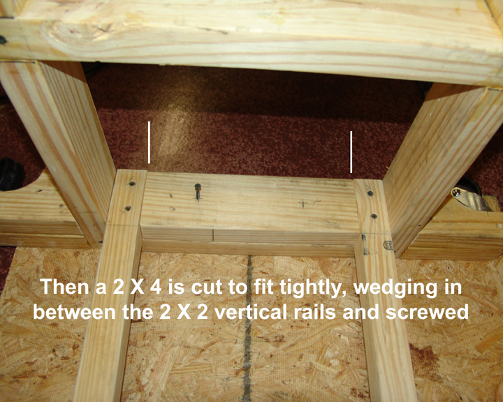

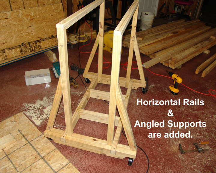

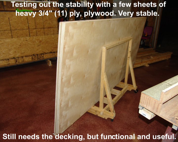

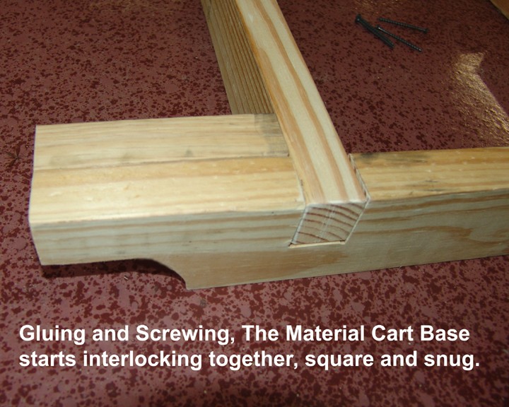

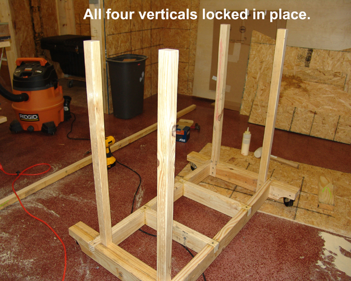

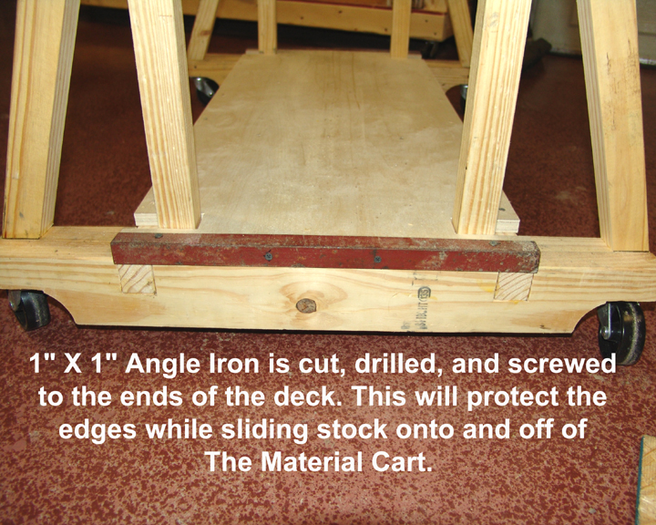

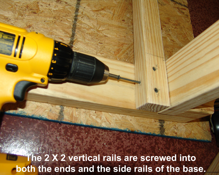

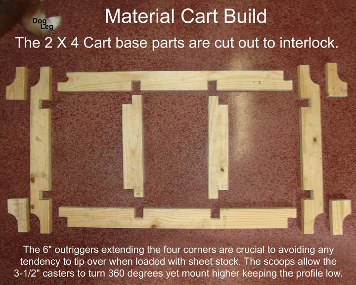

. Before moving on to sheeting the walls, and knowing I was going to have to keep moving things off from them as I go, I decided to take a little detour and build myself a material cart. This thing turned out to prove itself so handy, that I thought I'd share my design with you all in case any of you could benefit from building one.
Being one to believe I can make most anything out of wood, the amount of materials was very minimal. The greatest expense was actually the casters.
My goal was simple, Keep it low to the ground, stable when loaded with full sheets, and strong enough to handle moving several hundred pounds around the shop. All was achieved on the first attempt, and is holding up extremely well and without issue.
Here is what I came up with.
Well, hopefully this will give someone some inspiration. It has been well worth the couple of hours I invested building it, and has proven to be very handy to have around the shop.
Now time for me to quit Lolly Gagging and get back to work on the shop itself.

I love how you take the time to build something so useful and put so much energy into it to make sure it will function to such a high degree. I applaud you!

Wow. Your measuring, layout and position of hole skills are next to none.
My holes always are 1/2 inch off in one or two ways. Your rounded corners to fit the box. Applause sir!

Wow, thank you both jbmatth and thetastelingers for your high regards for my work.
Receiving "Applause" for my efforts from fellow garage and shop enthusiast enriches my feeling of pride in the project. Thank you sincerely for that.

Just thought I'd post a few pictures of the interior. I've gotten the sheeting done on the walls, and been building some of the benches shown in the layout plans drawing at the very beginning of this thread.
I hope everyone's projects are going well.
