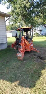

I run a 20 yr old Kubota Bx that's great after 1200hrs, so I am Kubota biased, but your 1210 that was great in the woods is a bigger machine than a subcompact. Buy the one you like with good dealer support, but consider a larger 1210 size and weight machine for the land work and get a zero-turn for the lawn. Good luck!
