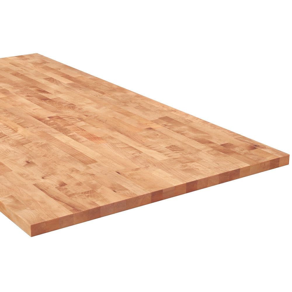

HD has a decent selection of butcherblock tops. You can rent a truck right there for 30 bucks. Here's one that's 39" wide, you can trim off three inches to get your 36" width if you're committed to that. Half the price if you can live with 25" wide. A quickie base and you're set. In my area I see disassembled packing tables on CL pretty regularly or disassemble yourself for easier transport.

Ikea sells butcher block tops for a reasonable price, but the last ones I purchased were made in China and warped. So I would be concerned about buying the, again.
