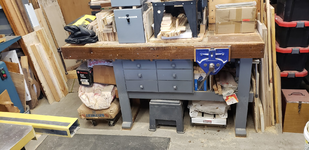

I picked up this beast this weekend for an absolute steal, $300. They were going to have to PAY to have it disposed of, made me sick to think about itIMG_8372.JPGIMG_8372.JPGIMG_8372.JPG. It has a 3/8" plate on top, Wilton C2 vise, Rigid bc810a pipe chain vise, and is plumbed for air lines underneath. Just need to add some casters and I'm good to go.
Very nice. The vise alone was worth the purchase price, but that looks like a nice stable table. :thumbup:
MAJOR suckage OP. That is the find of the year. That vice alone is worth driving a good distance for.
Come on man,
If you were a true Garage Journal Man you would have asked how much the other guys were gonna charge to haul it away. Then tell the owner you would do it for half that😁
