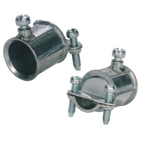

Back when I was an apprentice, we used these for EMT stub-downs...
Strip back however much armour you need (we were doing 8-10' whips) and tape the anti-short bushing on. Was ok with the AHJ at the time... but times change, so check if in doubt.
That fitting is for NM to EMT. AC connectors have stops to retain the antishort bushings.
Just as stripping the insulation off of NM and using the individual conductors in conduit is not acceptable, stripping the armor of AC or MC cable is no better.
I agree on the lack of stops. It was debated. Like I said, it was acceptable to the AHJ at the time. 100+ instances of those connectors on whips on a gov't institution job. Sometimes it doesn't hurt to ask the inspector.
The other version was PVC stub, female adapter, and a std AC set screw connector. But the PVC setup wasn't permissable in certain spaces per specification.
