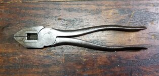

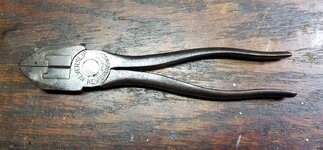

Today was my kind of haul as a collector at the flea market. I found a few tools made by mfgr’s I had never heard of before, which sent me to the history books, so to speak, one of the most rewarding parts of this hobby.
One of those tools were these nifty Neverslip lineman’s pliers.
The side-cutters, made from crucible steel, are replaceable – a feature they prominently advertised for its economic efficiency. They are each held in place with a screw that is countersunk in the outside of the jaws so as not to disrupt the profile.

If you’re thinking that "Neverslip” may be a catchy name, but it doesn’t seem to be in the least bit descriptive of the main selling point, so was I.
The name of the company (Neverslip Works), which was established in New Brunswick, NJ, in 1896 three years after my house was built about 25 miles to the southeast, actually comes from their much earlier horseshoe calk (patented August 17, 1897; D27,542) and a wrench with a unique conical and tapered opening (patented on the same day; 588,348), used explicitly and exclusively to turn the calks.
The wrench is considered a collectible by the horse-and-buggy set.
I haven’t yet located the patent for the pliers, but the earliest literature dates to 1920.
Out of curiosity, and for a more thorough cleaning, I removed the cutters. I tried several modern and vintage close-quarter screwdrivers before finding one that had a thin enough blade to fit in the slot of the screw, but wide enough to not tear up the head. Appropriately, it was a vintage WARDS LAKESIDE. Not surprisingly, the cutters needed a little coercion in the form of WD-40 and some taps with a drift pin and mallet to remove.
After cleaning the pieces and the screws, I reassembled it, but I prefer the brand side up, facing me, not down, where it could get gouged on the work, so I flipped the cutters around. (At least one of the ads showed them this way, so I am not being historically inaccurate!)

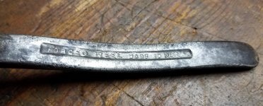

On the inside of both handles it is marked "Forged Steel".
It might have been made in an even narrower timeframe than you think.
My "PAT. APLD. FOR" pliers are marked "FORGED STEEL MADE IN U.S.A." in the interior handle panels, just like all the "PATENTED" pliers I have, suggesting that they added the "MADE IN U.S.A." to the die before the patent was granted, making yours earlier than mine.

Just got another Neverslip pliers. So I am comparing the patent pending vs the patented. The differences are small (besides the markings). The cutters are interchangeable. The screws are all 1/4-20 but the earlier patent pending ones are flat on the end of the threads where the newer one has a slight bevel to aid assembly. The handles on the patent pending are bent a little closer. The markings on the insides of the handles are Forged Steel (pat pend) and Forged Steel USA and a B inside a circle for the patented.
