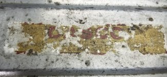

The set comes in a nifty oblong-shaped galvanized steel case with a flange-edged sliding lid. (Except for the oblong shape, it reminds me of early Army bacon cans.)
There's not much left of the label, but there's enough to identify it.
It reads:
DASCO
TRADEMARK
DASMASCUS STEEL PRODUCTS CORP
ROCKFORD, ILLINOIS
