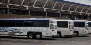

I assume the OP has a Greyhound type bus converted to a motorhome. Picture of buses showing the driver and tag axle. The trailers are the type of stuff I work on
The question is if you are out in the middle of nowhere, what can you use to change a tire on a Greyhound bus.
The op said that his Makita 3/4 cordless that puts out 780 ft.lbs working torque would not take them off. Would a new IR 3/4 air impact be better?
What I use is Chicago 797-6 1" impact that puts out 900 ft.lbs. working torque but requires 150 to 175 psi and weighs close to 30 lbs.

The vehicle is a Dina Viaggio 1000 coach bus. It uses 11R24.5 tires with the lug nuts torqued to 475 ft lbs. The wheels are stud pilot. The steer tires are BF Goodrich ST230 and the drive and tag tires are Roadmaster RM185. The engine air compressor is a Bendix Truflo 750 that puts out 16.5 CFM @ 120 PSI.
I don't see how any of this is relevant to my original question of if a 110 volt compressor will supply enough air for a 3/4" impact wrench. I currently own two 3/4" pneumatic impacts and would be willing to buy a 1" impact wrench if necessary.
I have a Makita XWT07Z LXT cordless 3/4" impact with 1,250 ft lb nut busting torque that will not budge any of the lug nuts.
