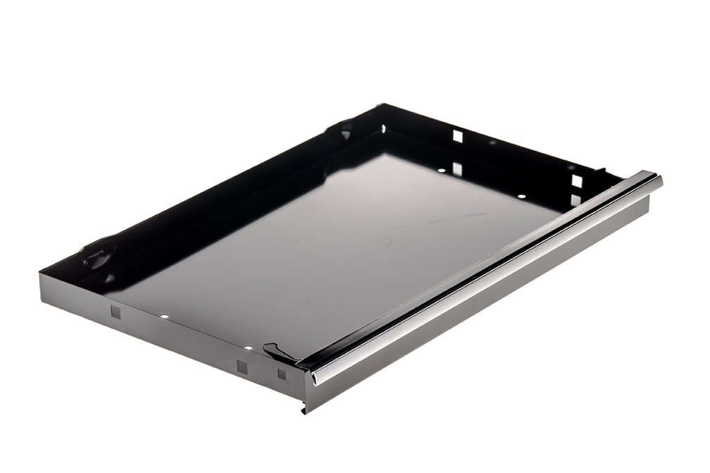

I have a smallish workbench that has a space under it for drawers. Right now the drawers are basically plastic boxes that slide in and out of wooden cubbies. I would like to replace this arrangement with toolchest-like drawers.
Is there anyplace I can go to buy toolchest-style metal drawers and slides without buying the whole toolchest? I've asked Mr. Google and Mr. Amazon, and they have not been helpful, but maybe I just haven't asked the right question.

Based on your description above these will be to large.
Craftsman 26675-EBE Replacement Drawer for Tool Boxes and Work Benches, Black
Craftsman 18197-EBK 2-Inch Drawer for Tool Chest, Black
Craftsman 18195A1-DB5 Tool Chest Drawer, Black
Craftsman A9066A13-EBK 2-Inch Drawer for Craftsman Toolbox, Black

Those actually look like just what I want, if I can jimmy some generic slide hardware onto them. The problem is that most of the websites seem to have the dimensions wrong. For instance, this drawer is described both by Sears and by Amazon as Craftsman 18197-EBK 2-Inch Drawer for Tool Chest, Black:
But Amazon lists its dimensions as 4 x 3 x 1 inches. Clearly that's not correct, but those are the only dimensions I find.

Just contact Waterloo and ask them.

Ordering replacement drawers from Craftsman is an OK way to go. I replaced several drawers in my Cman toolbox a few years ago by ordering stock CMan drawers and slides. Take a look at my Craftsman Tool Box Drawer Modification thread:
http://www.garagejournal.com/forum/showthread.php?t=180594
and look at post #14. Cman doesn't offer an unlimited selection of sizes. They offer only drawer sizes that are replacement for their boxes, but if you can identify a Cman box with drawers of the size you want you can just order replacements and make your own drawer frame.
