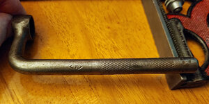

Found this ell-shaped box end at a thrift store. It looks old-ish. Trying to figure out the marking and what it might have been used for? My un-educated guess would be specialty automotive in a low torque application due to the short leverage of the handle and the thin wall of the box end.
I went through all the logos in the logo thread and did not see anything like this.
The overall length is 4.7 inches. The box end opening is 9/16".
Thanks for any ideas.

After the mention of Truth by you guys, I've looked at a lot of sources and not yet seen a logo for them that looks like <T>. However, the wrench 3bay posted is close in appearance. The only problem is, 19/32" is larger than my opening (mine measures 0.578"). Below is one that is currently on e-bay. It's size is listed as "slightly larger than 9/16" ".
However, the P&C catalog wrench IS listed as 9/16". So thanks to you guys it looks like this is a likely identity for the type of wrench this is! Thanks. Now to just figure out the maker and the <T> mark.

Old Fords used a bolt and castellated nut with a cotter pin for the crankcase, except for a couple under the starter that threaded into the casting. They were 3/8” 24. The heads were 9/16”, the nuts slightly larger. This wrench would have been useful when removing the crankcase in the car. If you see a bent 19/32” open end, that might very well be why it was bent. Most of my experience has been with the engine out of the car, so wouldn’t need this wrench.

I found another <T> marked tool. It's an ell handle with a fixed 3/4" 6-point socket. 11.2" overall length.
