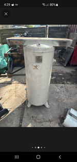

Discovered this week that my air compressor tank has developed a pin hole leak. It's along the weld at the bottom. It's a horizontal tank.
Its a champion porta-champ. My guess is it's from the late 80s/early 90s. I bought it used from an old guy about 10yrs ago.
It's a good compressor. Belt drive 110v, about 30 gallon tank size, v twin.
Looking for a replacement.
I don't use the compressor that much, but "1 day" I'd like to paint my project miata.
Here are what my options are:
1. Put the old pump on a new/used tank. This would require some work, I understand how a compressor works, but I have never done this before.
2. Find a reasonably priced belt driven compressor that runs on 110v.
I'm not interested in a direct drive compressor as they all seem rather loud.
3. Single stage 60 gallon compressor, but that requires 220v and I'm all out of room in my panel. I do have a n14-50 receptacle in the garage for the ev charger, but that's on the other side of the garage from where the compressor would sit.
If the compressor draws less than 20amps,i could put it in my basement workshop, although room is pretty tight in there as well.

My Champion Porta Champ compressor served me well for the 12 yrs I had it. The rust problem was likely my fault. It is on the end of the compressor away from the drain. My garage floor is sloped just a tiny bit for drainage. Probably 5/32" over 2'. On a 32" long horizontal tank, that would mean maybe 1/4" of water on the downslope end.
I do remember having shimmed up the wheels of the compressor in the past to get it level, but it wasn't shimmed for the past who knows how long. When I would open the drain, the water would still sit at the far end of the horizontal tank. That was my case. Operator error.
Some pics of my old compressor.
area of leak - u can see the rust stain on the floor:
I posted it up on facebook market place for $125 cdn. I put astericks around the leaky tank part. The pump and motor are still good. Just impossible to find a good tank for cheap around here. Maybe someone on there will have a good tank and burned out compressor that they want to fix up. My guess is around 5-5.5CFM at 90psi.

I had Makita Mac5200, but the tank at 5 gallons was too small, and something happened to it where it wouldn't turn off, even when it reached desired PSI.
I'm attracted to this horizontal air compressor because it's small and I'll put it up on the shelves by the ceiling.
Bmw4life
Apr 17, 2020
207
Canada
I guess my space between the shelf and the ceiling is only 20inches. So maybe something like this will fit, but I'm not sure if it's ok to be operated horizontally?
