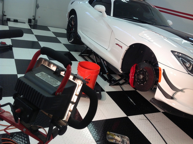

We see all kinds of lifts on RACEDECK Garage Flooring. Most common are the 4-post lifts right on top
my concern was that my midrise lift rolls on two metal casters on the rear and uses the front as a pivot point to lift the car up... so the full weight of the vehicle and jack are on these three areas and moving along this plane when the lift is operating... i'll give it go and run the RD under it and see how it holds up...
RaceDeck1
Oct 8, 2007
3,001
Salt Lake City , Utah
You should be fine, but we have seen a few cool installations doing it differently.
The first picture is our RaceDeck Pro, a metal topped surface. The Second is a lift with wheels on RaceDeck and the last one is one where a customer got creative
