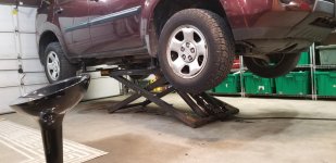

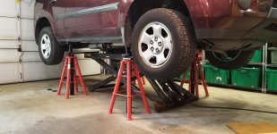

It seems most garages don't have enough head room for a lift, and I don't really want to build another garage.
So how high is the ceiling? Obviously that is the biggest limitation and the most important thing to state.
If it's 8' up to 10' then I'm gonna suggest the good old mid-lift.
Not to mention being the perfect lift table.
Most recent use below. 8' ceiling and a fairly tall Honda Pilot. Can't wait to move the rafter ties up a bit to get more height. Sometime I rest the vehicle on the jackstands and lower the mid-lift for exhaust or trans work.

That scissor lift looks like a lot of fun to crawl under. It would be my absolute last choice. MaxJax would be so much more pleasant. I’d buy quick jack before that scissor lift.
That seems like it may be a good option, I'll explore that further. What brand is your lift? Thanks!
JRC3
Jun 30, 2014
12,481
Southwestern OH
Greg Smith Equipment used to sell them when they where Hanmecson Lift and then Rotary bought them to sell under the Revolution name. There are many other brands that make the same style lift. Jack stands are Sunex 1410s, you can find them on ebay for $239/pr.
