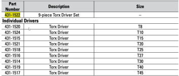

Torx Bits comparison:
CAT TORX 194-3584 is a 9pc in my opinion, the inclusion of the E8 is weird. Its a mixed drive set and is missing the T27 in my opinion, obv CAT doesn't use that size fastener. its $60 from my dealer. Adding the Williams T27 (MADE IN TAIWAN) JHW35084 in 1/4" drive is $7 (exc shipping, etc).
Williams Torx is avaiable only as solid size sets, so would need to buy individuals to make a matching set, or buy both the 1/4 and 3/8 set with some overlap. Also, these are MADE IN TAIWAN.
JHW30908 is 1/4 T10-T30
JHW31910 is 3/8 T25-T50 (T55 is not offered)
Overlap is T25, T27, and T30 in both 1/4 and 3/8, and T55 is missing, and not USA sourced.
I would recommend going with the CAT and adding SO for the T27 (TTX27E) at $40 or find used.
431-1522 - 9pc Torx Driver (Hard Handles) $173 at my dealer. Not a good deal IMO.

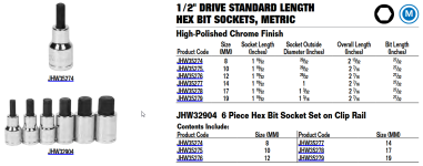

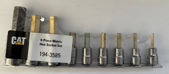

HEX Sockets Comparison.
CAT Metric set = 194-3485 = $82 at my dealer
These skip sizes, important ones in my opinion, but they do appear to be true Snap On with the gold hex shafts, except the 17mm?
missing 6mm, which is an important size. 9, 11, 13 not so common. To get the sizes I need, I will need to add Snap On 6mm and potentially a 19mm (trans drain plug on some stuff). FAM6E is $33 so that makes the sets about the same cost.
SHRM19 is probably what i'll go with for the drain plug, its only $43 instead of the $82 for the standard style SAM19E.
The Williams sockets for metric are made in Taiwan, so the CAT deal looks to be a good buy. To get the same sizes, you would spend $110 and the tools are not made in USA.
Williams offers only solid size sets (1/4 or 3/8 or 1/2)
The 3/8 set is $37 and goes from 4-10 without skips.
The 1/2 set is $65 and goes from 10-19 with skips (of uncommon sizes, so not a big deal). All the common sizes are included.

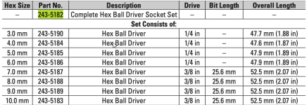

Metric Ball Set 243-5182 = $93 at my dealer
This set does cover the missing sizes of the standard set. It appears to be snap on based on the knurling.

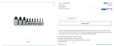

Interestingly, Williams does offer USA made SAE hex bits, but they are more expensive than the CAT ones.
JHWSBS10RC is a similar mixed drive set with 10pcs, 7 3/8 from 1/8-3/8 and 3 1/2 from 1/2-5/8. I would put good money these are the same sets/tools. Snap on doesnt offer gold bits for SAE tools in my understanding.

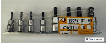

CAT SAE Ball End Set = 246-8499 = $94 at my dealer
This is an 8pc mixed drive set
Williams only offers solid sets.
JHWWSBB7RC is a USA Made 3/8 drive set offering similar sizes for a bit less money, if this covers what you need.
missing are 3/16, 9/64, and 7/32 which are fairly uncommon in my experience. 3/16 and 7/32 are made and can be added for about $10 each (JHWBA-6A and JHWBA-7A)
The 1/4 set covers those sizes but has many more as well, so ends up being more expensive. (at attachment limit so look up JHWWSM-11TRC) its an 11pc set from 1/8-5/16

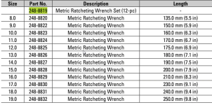

Ratchet Wrench Comparison.
NOTE: CAT does not specify USA made, and the Williams are made in Taiwan, so I'd guess these are all offshore production. For me thats probably a pass, but YMMV.
CAT 248-8819 METRIC 8-19mm 12pc set = $226 at my dealer
Williams Jhwmws-12Rc is an identical set from a sizing perspective. Wrench lengths appear to be identical as well (maybe some rounding?) Currently looks to be $170 on sale at SCPT, so seems like a much better deal unless you want your tools to say CAT.

I'm looking at the ball end hex socket sets... were yours rebranded Snap-on USA stock? I don't want to end up with Blue-Point/Williams Taiwan ones if spending that much.
I don't have the ball end sets, but so far as I can tell my regular sets are Snap-on equivalent. They are marked USA and have what appear to be Snap-on date codes.
I will say that I've noticed the finishing is inconsistent within my sets - not necessarily better or worse, but from socket to socket there is some variance between high-polished chrome and a bit more of a matte look.

Any chance you can post some photos showing the finish variance in the sets you bought? Are you referring to your hex socket sets, or 6pt/12pt socket sets as well?
I'm looking at making a big purchase very similar to the list you gave in post #17 (by the way, thanks for posting all those part numbers).
Not the best lighting, but hopefully these help.
On this set the 15mm is matte. 12 and 13 are polished. 14 somewhere in between but closer to polished. 16 and 17 are matte at the base and polished above:
On these hex sockets, all are matte but 7/32 is polished (note the hex bits are black; photo is a bit misleading in that regard):

This screenshot of the catalog shows extra sockets (266 and 541 prefix) that don't belong in this section.
