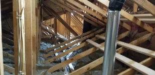

Want to add a catwalk inside the attic rather than having to walk truss to truss. I was thinking of a 14" wide plywood sitting on 2x4's that are nailed between the truss upright and diagonal. Basically nail the 2x4's to the side of each truss uprights and diagonals. Two 3"+/- nails, then lay 1/2" plywood across those 2x4's. The trusses were put in in 1979 and they have lived in a hot attic most of their lives. I can't think of any other way to do this. The reason is that will be adding more insulation and it is already hard to walk between trusses when you can see them let alone thru a deep field of insulation.
Anyone do this? I looked at simpson ties that might work with the 2x4's butted to the upright and cut to lay on the diagonal but did not see anything that seemed appropriate except mend plats.

Like the top truss in this image I borrowed off the web. I am looking for a lite weight and simple solution.

You are going about this all wrong, you have a tunnel like opening through the webbing of the truss right? Attach a 3/16" or larger wire cable end to end, get yourself a good harness, click in and Mission Impossible it through the attic over the insulation.

Tom Silva from TOH has an interesting way to construct a catwalk. He uses 2x blocking attached to the bottom chord of each truss. Each block would be 16" long cut from a length of 2x6, 2x8 or 2x10 depending on the total thickness of your insulation. Instead of attaching the blocks with plywood gussets, I would use pocket screws along the bottom and one edge of each block to attach the blocks to the bottom chords and vertical truss members. All of the blocks could be cut and drilled in your workshop and then taken into the attic and attached to the trusses. Pretty simple. Again, use 5/8" plywood for the walkway.
https://www.thisoldhouse.com/ask-toh/attic-catwalk
Edit -- With the type of trusses you have, the bottom of each block would be attached to the angled truss member instead of the bottom chord. If the existing steel gusset plate interferes with placing the block, you may have to cut off the corner of the block.

The idea re Tom Silva I read at least 10 times the other night. I cannot visualize what he is doing. The trusses are 24" apart. There are wires and pipes running in some places between trusses so putting blocking in between the bottom chords may not be that easy.
There is a single block on each truss. There are no blocks between the trusses. The edge of the block is against the 1-1/2" side of the vertical truss member and the bottom of the block sits on the top of the angled truss member. The block is 1-1/2" thick, 16" wide, trapezoidal in shape and as high as the top of the insulation. I suggested attaching the blocks to the vertical and angled truss members with pocket hole screws. The 16" wide, 5/8" thick plywood catwalk is supported on the block at each truss. If your trusses are all the same, the blocks will all be the same so you can cut and drill them in your workshop and then take them into the attic and screw them in place.

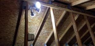

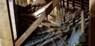

I may or may not be guilty of this. I added catwalk to both make it easier to get around in the attic and to protect some wiring.
The first set of catwalk I put down was to protect the new service entrance wiring going out to my addition for the subpanel. I kind of expanded it from there.
I've also added three different sets of three LED 100-watt flood lights and added a duplex GFCI protected convenience outlet in the same box as the switches for those lights.
I've cleaned up a bunch of the existing wiring that was run haphazardly around the attic by mounting it to running boards and I've ensured that all new wiring I've added is also mounted on running boards.
