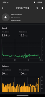

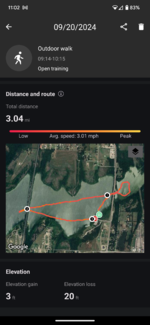

We averaged 3mph this morning on a 3 mile trip with me doing almost all the paddling by myself. The wife was busy site seeing and taking pictures.
IIgnore the 15mph. That's fake news.
