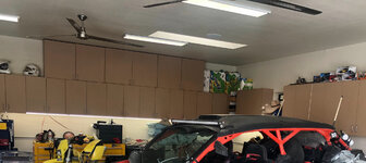

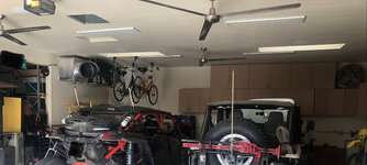

Dig Doug
Apr 16, 2018
1,128
I went with Casa Vieja
mine are 84 dia. All 3 units are on a single wireless remote, they stay on 24/7 when I’m at the house ( lake house ) they are about 8 years old. Price is $249 to $400 depending on size and if on sale!
I need 2 more for the boat stall
Disclosure -
Garage is a disaster…
