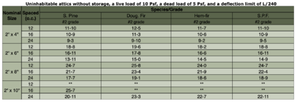

I have a stick built roof (rafters, not trusses) with 2X6 ceiling joists and a central supporting wall. I want to get rid of the supporting wall. Could I sister the joists with Douglas Fir 2X10s to achieve a 24' span? We have no storage in the attic.

Is there a ceiling or are these just rafter ties?
What is spacing of 2x6's?
Probably you can but wanted a little more data before saying for sure.

There is a ceiling. 2x6s are on 16 centers.
Then 2x10s would be great
As I am moving some other interior walls around, and thus the existing drywall would be a hodge-podge of repairs, etc., I was thinking of stripping all the drywall of the ceiling which should give me room to manipulate the new joists into place.
That would be the best. The 2x6 would actually be doing nothing once you put the 2x10s in. You could salvage them for other purposes

If you have help, lay the 2x10s flat onto the top plates and the middle wall then roll them up into place. Three or four stout guys would be good. If you can’t clear the middle wall, cut it out in pieces one bay at a time, then slide in the new wood. This after you dub the upper corners off to clear the roof decking. I would not take any of the existing joists out, but sister the new joists directly to them.

I think you guys talking about hanging this from above are flirting with extreme overkill. There are going to be a lot of situations where a really light connection from the center of the ceiling to the roof at each joist is going to be adequate.
Obviously a truckload of 24 foot 2 by 10's is also a lot of money.

This ^. if the attic will not be used for storage adding a vertical tie to make a king truss should be fine. Just need to make sure the joist to rafter connection is good along with the other connections. Should be pretty stout already to support the roof but should be checked.
Firebrick43
May 12, 2015
14,450
West central Indiana
In post 16 they show a king post with the notation of up to 16’.
The OP garage is 24’ which would need to be a Howe.
And then there is incorrect info post led about using screws (t50???)which is a bad idea as well.
I have built a few site built trusses with ply gussets to engineered plans and the want lots of number 6D nails. As in 50 per side for each gusset. They want lots of little load point spread out, not big screws. Same reason they use mending plates for factory trusses.
It’s hell enough to do so on the ground flat let alone built up in the rafters

Half the ceiling and insulation - 5psf (no storage what do ever,) or 60plf. Storage would quadruple or more, and seems inevitable in the life 8f ty he building.
In TN, it would be like increasing each rafter span a foot, not a lot. More like 3 to 5 feet with storage. Don't know what rafters are now. Do know many older garages have rafters undersized by current code, so if changing with permit, might cause problems.
The 2x10 solution is brute force simple. I'm also skeptical if truss-worthy connections with oveylapping 2x6s and who knows what kind of alignment between rafters and joists. Very unlikely king posts can ve plumb, which would raise eyebrows. And trusses always seem to have a pretty good connection where the rafters meet. How do you do that through a ridge board?

I agree that it's likely to get storage at some point so would be good to try to size for that. Also that doing this depends on things lining up in the existing framing. The ridge board could be handled by a large gusset just below the ridge board that covers both rafters and the king post.
But for loading you don't just add the ceiling load to the rafter load. That is overly conservative so I guess you could but that's not the actual loading or stress.

This is in my living room/dining room area, and it absolutely will not ever get storage (it's not easily accessible).

So you probably do not want to raise ceiling. I think I would go to either 2x12s or, perhaps TJIs. TJIs would be more level and easier for one or two persons to get into place, and stay straight enough. I worry the 2x10s will deflect enough to be noticed - ok by me in a garage but not a living room.
The suggestion to install a beam, either in line with joists or - with a lot of thought on connection - maybe on top of joists. I like the ease of installing beam, connecting to joists, and then remove wall. Again I'd have to think that through. Flush with joists and joist hangers doesn't feel like a good connection for the rafter tie function. Maybe needs a steel strap across bottom.

No it’s not a rule but it does have some basis in it designing trusses in common construction lumber.
If you see large span king post trusses it’s usually done now days for style with larger lumber and bolted gusset plates as the stresses are concentrated into a small area
And I can’t say I have seen any true king post style trusses in 24’ long, eve timber framed. A lot of timber frames are the queen post style in those spans, which for some reason people incorrectly call king post.
But any semantics isnt going to erase the need for an engineer.
7 years ago the minimum charge for a stamped drawing by a practicing engineer was $500. I can’t imagine that it’s stayed the same and would likely be $750 plus. Using joist does not incur an engineers fees.
Menards shows a 24’ 2x10 for $55.69
$750 dollars will buy 13 of them which will do 20’ of the length of the building.
And by the time you buy quality ply for the gussets @$50 a sheet, the vertical members and a nail gun I do not see how you can save any money by converting to a truss.
And it will be a hell of a lot easier setting joist than trying to align and build a truss in situ and keeping them all in plane on the bottom cord even with a siding nailer
