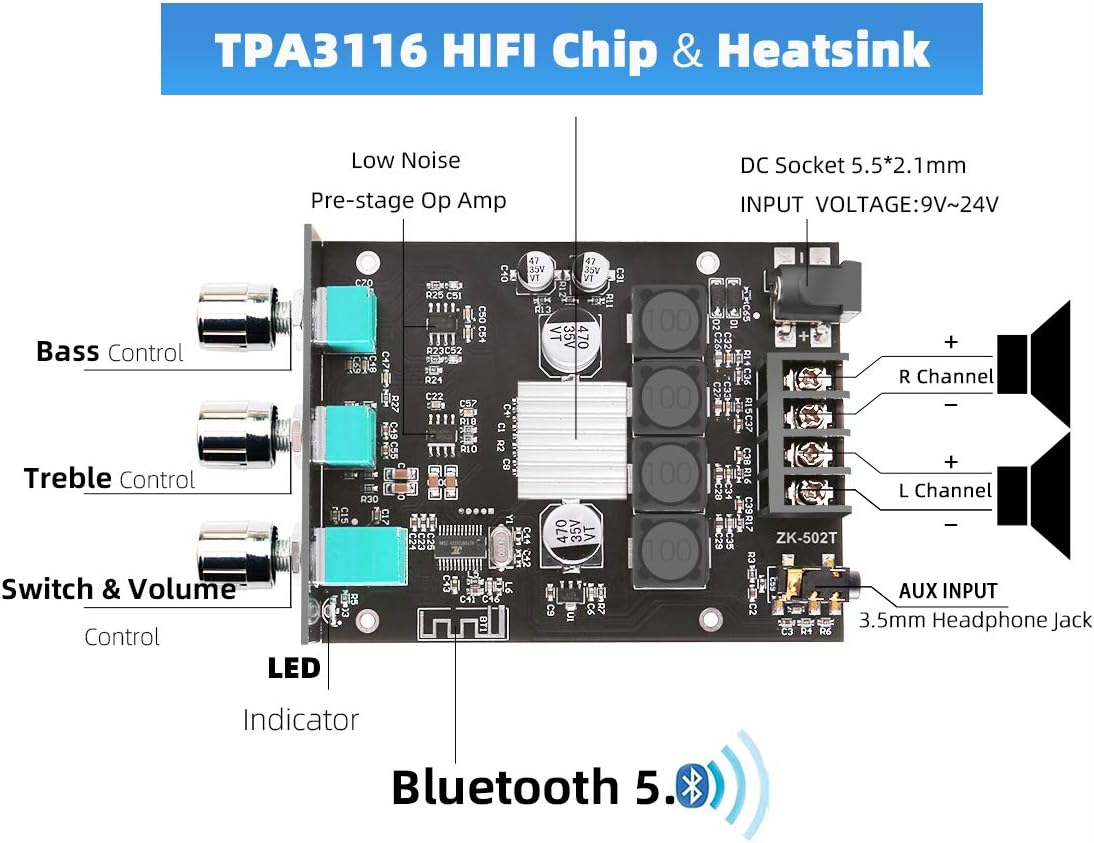

I ordered these speakers: https://www.amazon.com/gp/product/B01JH3PS1G/?tag=atomicindus08-20
The Raspberry Pi 4 and hat AMP are on backorder. Gives me time to get the wiring done.
I ordered this PSU: https://www.amazon.com/gp/product/B071JLNB9R/?tag=atomicindus08-20

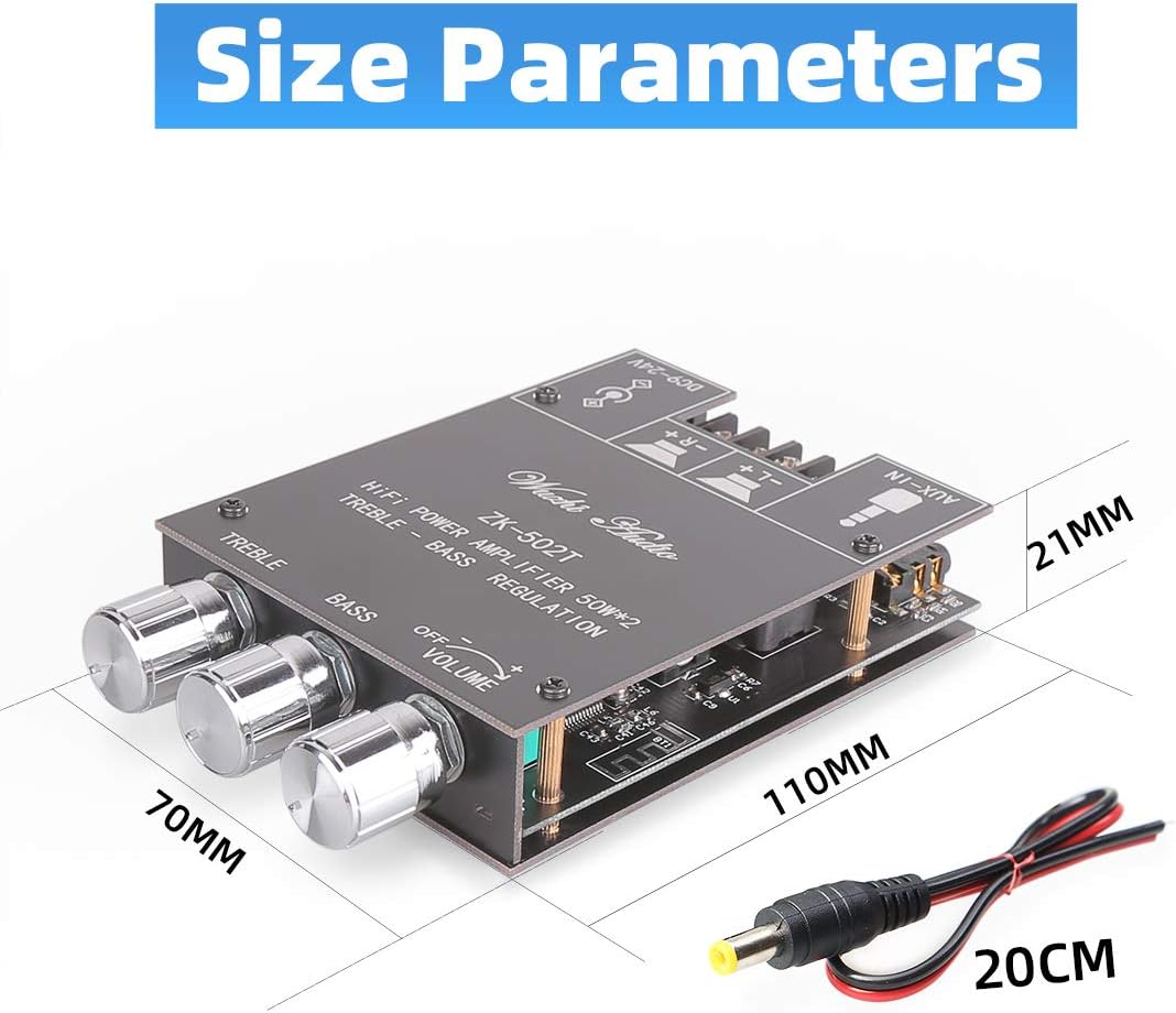

Since the PCB amp is on back order, you might want to consider getting a PCB amp with bass and treble controls instead. In an acoustically perfect room, with perfect speakers, you technically don't need them, but in a echo-prone garage with small ceiling speakers, you should be able to get better sound quality out of what you have using the bass/treble controls.
This one for $21.95 is in stock and has bass/treble (https://www.amazon.com/dp/B088BP48Z9/?tag=atomicindus08-20).
The amp also has Bluetooth 5.0. Yes, I know you said you had issues with Bluetooth, but never hurts to have it (when it is essentially free) just in case you want it down the line. Bluetooth 5.0 has come a long way since the early days, should work fine within 30 ft.
