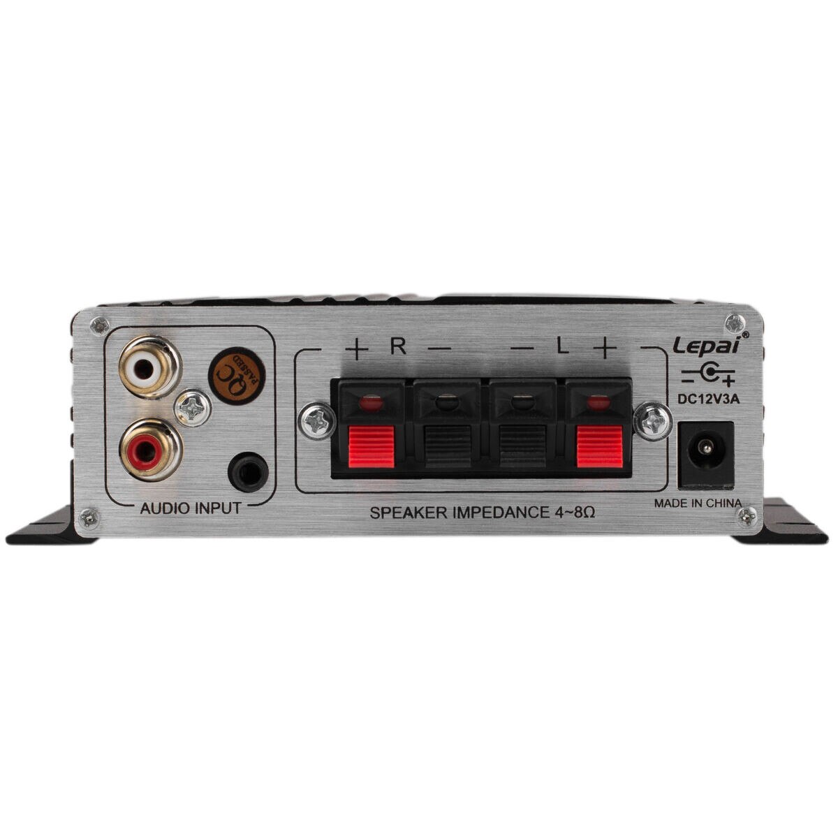

Honestly, the Lepai amp at Parts Express I posted in post #64 is fairly broadly considered the best available, sound-wise, among very cheap amps. It sounds great and the bass and treble controls will help you dial in the sound since neither the room (echo-prone garage) nor the speakers (ceiling speakers without a baffle) are perfect. The 36w (12v/3a) power supply that comes with it is only good for modest volumes though, it's best to look for a power supply around 60 watts. I think that the it will handle your 24v power supply, but double check the amp specs to confirm.
The rPi AMP hat may be fine -- most of these tiny amps sound surprisingly good, but no bass/treble controls. How will you adjust volume with the rPi DAC+AMP? It seems like it assumes you have a keyboard/monitor attached to turn volume up and down (or maybe it can be done via app). I used an rPi 3 to build an arcade for my son, but have never used rPi for audio.
I don't think I would do the amp with the built-in fan -- the fan noise might become annoying and the Lepai with upgraded power supply should go loud enough.
I found the self-contained amps to be easier to deal with than an amp board, but that obviously depends on what you are building.
https://www.parts-express.com/Lepai...dio-Mini-Amplifier-with-Power-Supply-310-3000
I've read that the newer Lepai's with the Texas Instruments chips are not as good as the older models, the LP-2020A which was the one so many people raved about. I like the little Lepai amps and have one paired with a set of Paradigm speakers on my porch. I would caution that they are low power amps. They worked nicely with my Paradigm speakers (gen 1 Titans, a 6" bookshelf speaker) but poorly with my similar sized NHT bookshelf speakers. The NHTs simply require more power and the amp can't keep up. Basically these are great amps for background sounds with efficient speakers. They are no good if your speakers need power. I also don't know if the TI model is as powerful as the older model. Shop with care.
All true. I have had both the older version and the newer version and I don't hear a difference between them. The older version can no longer be produced because the chip is NLA. I think the older version could handle more amps than the included power supply put out, but it was limited to a 12v. I say that because I blew one up plugging in an 18v power supply forgetting the 12v limit (hopefully I am remembering that right). The new version is all that's available now and I think it can handle 24volts.
For whatever reason, both old and new came with a power supply that is far too wimpy. It's marked 3A/12V (36 watts of power), but I suspect it actually puts out a lot less than that rating because volume is definitely limited with the stock power supply. If you upgrade to a power supply with a voltage and amp rating that puts out 60 or so watts, the amp will go to quite loud with any reasonably efficient speakers.
