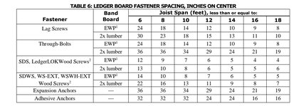

This is from the Prescriptive Residential Wood Deck Construction Guide based off of the IRC. You need 1/2" if going into solid concrete/masonry.

The table in post #13 is what you want. Nice posting!
Tapcons are fantastic for holding stuff while you really fasten it, holding grout formwork, attaching lightweight items, etc. They are not fantastic for load bearing work, unless they are the really big expensive structural ones they sell.

Ya, been studying that. Looks like I need 1/2” bolts. I’m going into solid cement.
