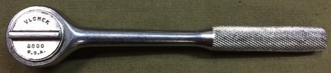

Here is a close-up of the ratchet, spinner, extension heads, adapter, and spark plug socket. The ratchet is the only piece that is marked like the logo brand name (“challenger”), with no capital letters, all the others are all caps (“CHALLENGER”).
View media item 76423
View media item 76426
View media item 76427
View media item 76429
All the sockets are marked in two lines - with the model number, “CHALLENGER” brand, and the size, over “MFD. U.S.A.”….

Thanks for posting the pic of the ratchet. I was wondering who made this Vlchek 3/8in drive ratchet. Looks to be a spot on match to your Challenger ratchet. Which makes sense after looking at the sockets side by side.

View media item 76430
It's obviously the same set. Mine is 100% complete, and my box and pieces are in NOS and near-mint condition. But his has the cool label! :)
I just wish he had shown a close-up of the label. It might include a date or a hint or two.
CONTENTS
3/8-inch drive Ratchet 1260
3/8-inch drive Extension, 3”, 1265 (with the family “*” mark on the indent)
3/8-inch drive Extension, 5-1/2”, 1266 (ditto)
3/8-inch drive Spark Plug Socket 1326
3/8-inch drive (female) to 1/4-inch drive (male) Ratchet Adapter 1253
Nine (9) 1/4-inch drive sockets, 3/16” to 1/2”, 1006 to 1016, including a 7/ (1007), 9/ (1009), and 11/32” (1011) if that helps with date
Eight (8) 3/8-inch drive sockets, 9/16” to 1”, 1218 to 1232
View media item 76424
View media item 76425
….except for these two (2) sockets, the 3/8-inch drive 1218 9/16” and the 1/4-inch drive 1010 5/16”, which are marked [PROTO]® U.S.A. !
View media item 76428
One more thing. There is an “X 9082” mark under the spark plug socket. That has nothing to do with the spark plug socket, and it almost looks like a set number to me.
View media item 76431
I think that label gives a very strong hint. I see a PTII marking on it which likely stands for Pendelton Tool Industries Inc. That logo is not on the 1964 up box labels posted. So it's likely 1963 or earlier.
