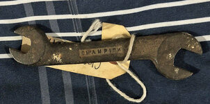

Any idea of the manufacturer of this double open end? Is this from Champion Mower & Reaper, or Champion De Arment Tool Co., or some other "Champion" company?
It looks to be carbon steel so maybe it could be an older Farm wrench made by/for Champion Mower & Reaper? However, something about it just does not look that old.
Champion De Arment did make some DOEs (see 1928 Champion De Arment catalog excerpt below found at Alloy Artifacts)
It's 9 inches long and 7/16" thick.
Edited to add: Openings are 1-1/8" and 1".

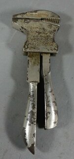

Well, here is an interesting twist. I've now found a straight wrench like mine (online) that has a backwards "N" like d42jeep's S-wrench.

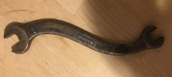

I recently received the 501 wrench. The other mystery wrench is the one I’ve had for a while. The 501 is the one with the backwards N.
I also have a 501 with the backward N.
Now I wonder if ALL of the 501's have that miscue.

That Champion adjustable may be a implement wrench put out by Champion harvester co. before it connected with others to form IHC in 1903.
Dang, you guys are great at having threads that answer so many questions, but leave so many more.
Here is one Answer I can help with: No
And the still possibly unanswered, who made it? The catalog cut in post #1 is a Champion S wrench #501, and has the anvil logo that Champion de Arment used in the 1920s. Are we satisfied with that answer?
But anyway 1/2" & 9/16", but both sloppy / spread a bit

Again: to reiterate my statement above: The "S" shaped service wrenches on the LEFT were made by Champion Tool Co. (or Champion Wrench Mfg. Co. or Champion DeArment - take your pick.)
It has not yet been definitively ascertained who made the 22½° offset double-open-end "textile" style wrenches on the RIGHT.
As of this posting, they remain a mystery (along with the odd "Champion" adjustable in post # 25
This same company also manufactured a variety of nippers branded "Champion".
We can continue to bang our heads, read tea leaves, astrological forecasts, or try to read "signs" from animal bones tossed on the ground, but I doubt any further effort is going to answer any questions about "backwards N" or "Chevron" forgings on these wrenches.
Notwithstanding all speculation and conjecture, Occam's Razor says these wrenches were made by Champion Tool Company or Champion Wrench Manufacturing Company or Champion DeArment at some point between the last decade of the 19th and third decade of the 20th century.
You are free to speculate further. You are welcome to chase the "Syracuse Wrench Co." fable down as many rabbit holes as you wish, but I honestly don't think you're going to get any closer to a definitive answer.
1920 Kelley-How Thomson Co. catalog "Champion" hoof shear (patent 908969 Jan 5 1909 George B. DeArment)
Champion Tool Co. (Meadville PA) hoof shear (patent 908969)(ebay 334282654505 01).jpg
Champion Tool Co. (Meadville PA) hoof shear (patent 908969)(photo: ebay 334282654505 01)
Champion 500 "S" service wrench with backward "N" character (photo: ebay 265629306593 01)
Champion S wrenches with mention of Syracuse Wrench Co. (twertsy 01)

They also just happen to be the company who made that odd "S" shaped service wrench stamped "OK CHAMPION" with the little chevron shapes at the ends of the shanks:
OK Champion open-end wrench (photo: George Roberts 01)
OK Champion open-end wrench (photo: George Roberts 02)
