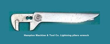

Champion / Champion "Lightning" wrench see Champion Machine & Tooling Co. / "Lightning" wrench / patent ? /

Moving right along, we come to a "Champion" "Lightning" wrench manufactured by one Champion Machine and Tooling Company whose whereabouts are unknown:
Champion / Champion Machine & Tooling Co.,
This delightful little number remains a mystery. We know it's a "Champion", and we know it was made by "Champion Machine and Tooling", and they apparently believed it was "Lightning" fast. That's about as much as we know at this point. Looks suspiciously British to me, but that might just be my wild imagination.
Champion Machine & Tooling Lightning wrench (patent )(photo: ebay 174703898833 01)
Champion Machine & Tooling Lightning wrench (patent )(photo: ebay 174703898833 02)
Champion Machine & Tooling Lightning wrench (patent )(photo: ebay 174703898833 03)
Champion Machine & Tooling Lightning wrench (patent )(photo: ebay 174703898833 04)
Champion Machine & Tooling Lightning wrench (patent )(photo: ebay 174703898833 05)
It's actually made by Hampton Machine & Tool Company of Hampton, Iowa.
29,643
o_O
It certainly does. No idea how I read that as "Champion" :headscrat
It is definitely "Hampton"
Hampton / Hampton Machine & Tool Co., Hampton, IA / acquired 1946 by Davies Mfg. Co. / "Lightning" pliers wrench /
  • Hampton Machine & Tool Co. Lightning pliers wrench (wrenchingnews Apr 2011).jpg
