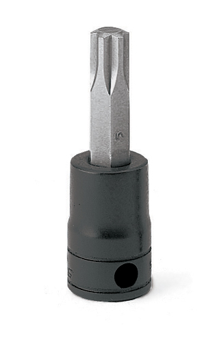

Be VERY CAREFUL with T47.
There's at least two wrenching forms that are similar enough to interchange tools--until the torque load goes up.
Older GM cars had the door strikers (and maybe seat-belt bolts) installed with a (superficially) Torx-looking tool, but on closer examination it's absolutely not a rounded Torx form. (It may be designed by Textron, Snappy uses the Torx trademark for this tool...but it's not the rounded style that became popular later.)
The Snap-On number for this older not-quite-Torx driver is GFTX500E, while the replacement bit itself is GFTX500E2
http://store.snapon.com/TORX-174-Sp...TORX-174-GM-Style-Industrial-T47-P631940.aspx
I am not aware of any other company selling a competing tool.

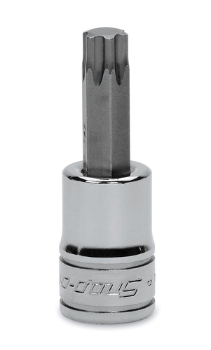

The second form of this is more rounded like we expect Torx to be. Snap-On p/n FTX47E, with a replacement bit FTX47E2
http://store.snapon.com/TORX-174-Sp...ket-Driver-TORX-174-GM-Style-T47-P636916.aspx
Wakefield
Aug 26, 2010
5,175
Arlington VA (but would like to get out to country
I have a "T-47 USA" that came in a set of "MAGNA" that is silvery plated 3/8" drive and one piece--I think it was ordered from a Kent-Moore catalog.
Interesting about the Snap On--so the newer FTX47E is not exact equivalent or exact replacement for the (G)FTX500E
the shiny one piece T-47 has rounded outer edge like the second Snap On in the pictures (post 44) (edit) looked at my Snappy it is FTX500 with no E and the driver part is chromed
