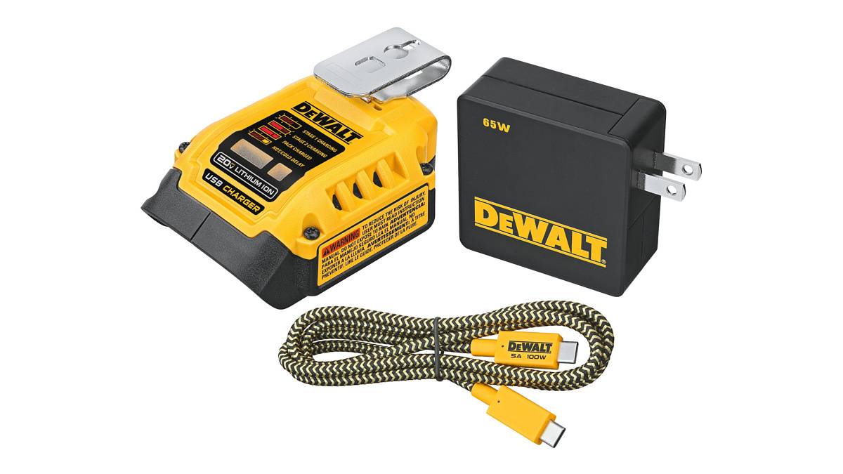

Charge your cordless tool batteries via USB-C?
Viper98912
Oct 20, 2012
1,130
GA
The latest version of USB-C with power delivery has the ability to charge 20V @ 5 amps. So if battery manufacturers start going this way, that'd be amazing. No more endless cables. I really hope everyone starts going this way rather than having 100 different charging cables for everything.

Que?
Being able to charge my Dewalt batteries using my existing USB-C sources is the point (vehicle or solar, primarily). The rest of your post baffles ME!
If I discharge my Dewalt battery on something else, that means I no longer have that battery to power my Dewalt tools. That's the only point of having those batteries with me.
If I need to power a phone or laptop, I use my portable lithium battery with a built-in inverter.
Different tools for different tasks.

I'm looking forward to this as a field engineer we run Dewalt stuff and it means I can just grab a battery from the charging station and recharge my laptop, I'm no longer stuck trying to work where ever the charging station is

No - 20V, 5 amps. And a few different variations of 100W in general. USB-C has some very interesting prospects.
That is the MAXIMUM and it requires a special cable (standard USB-C cables can only do 3A).
The charging standard (USB Power Delivery) has a lot of "loopholes" ! Typically, any USB-C device should be able to deliver 5V@3A. After that, the "source" and the "load" NEGOTIATE what can he delivered (I want 20V@5A. No can do ! How about 20V@3A ? OK !). Because of the special cable requirements most "wall warts" only deliver 60W.
You MUST have USB-C connectors on each end as the negotiation happens on separate wires.
There is no such thing as a "standard" USB cable. That's like saying a "standard" air hose or a "standard" extension cord. All USB cables have ratings for the amount of power and type of data they can carry.
Also, I the USB - PD 3.0 standard used for this Dewalt device is not even the newest protocol. An updated 3.1 specification will allow for even higher amperage and voltage combination up to 240 watts. And yes, like all USB applications, you will need to match the cable to the need.

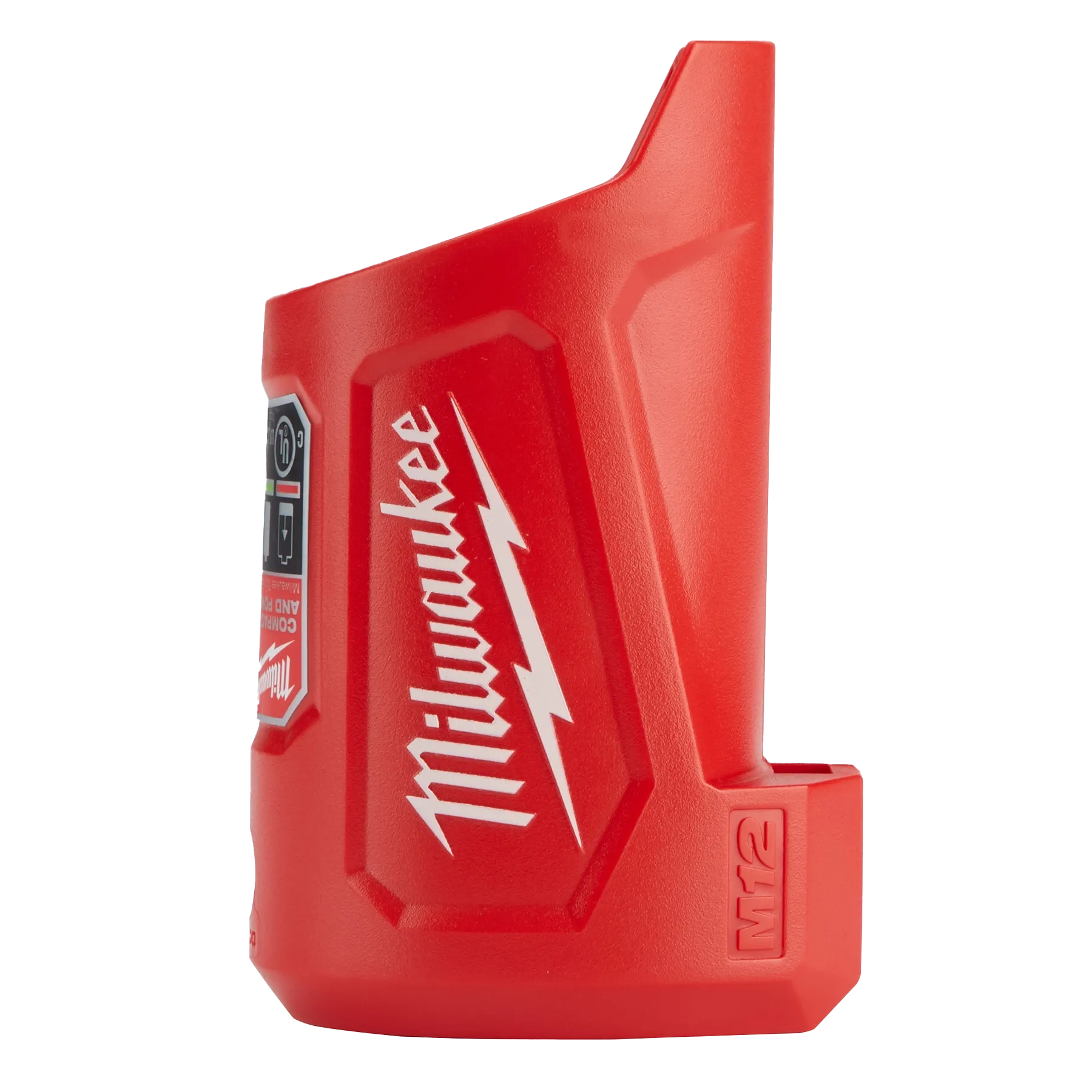

Milwaukee has an M12 single battery charger / power supply that will charge M12 batteries via 5V USB into a micro-usb connector. It's one of my favorite M12 items and I carry with me all the time as it makes a great little USB powerbank for charging phones and tablets. It has a micro USB connector for charging an inserted battery. It has a USB-A connector to provide power. It also has a coaxial power connector for a barrel plug which, I believe is to use with Milwaukee heated clothing items.
USB-C PD will supply 5V, 9V and 20V up to 100 or more watts in various versions of the specification. with computer equipment, USB C connections can deliver video, audio, ethernet and power. Pretty amazing how seamless it works.
