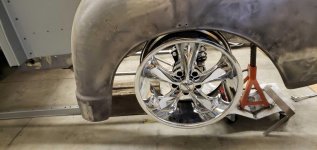

Cab and truck bed put into position to allow determination of the differential length. Using a 12 bolt GM with larger Ford bearings, upgraded axles and modified carrier bearings. Should be good for 700+hp but engine will be no where near that range.

Mocked rear suspension up to allow fabrication of brake lines evaluation of wheels.
