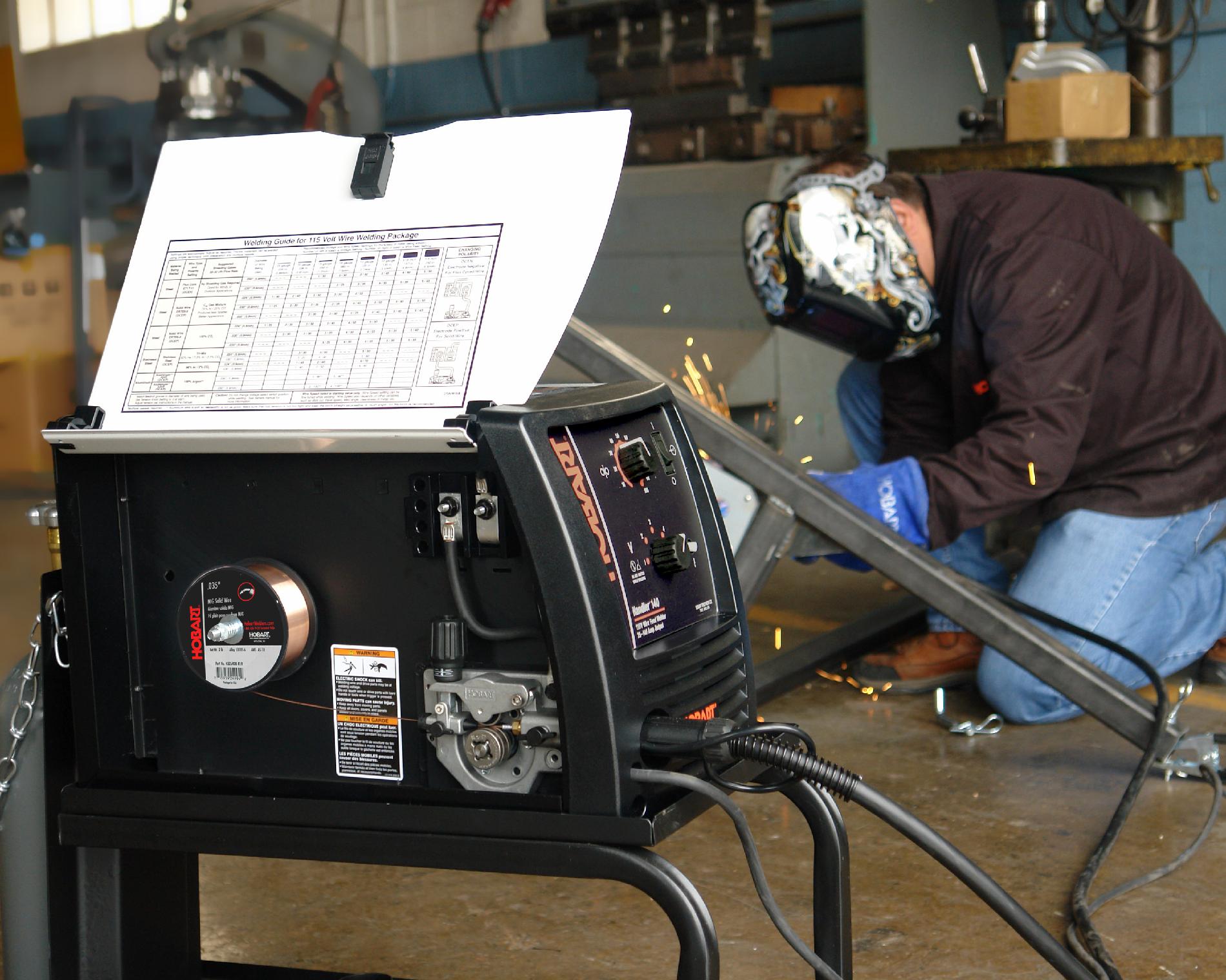

Well, I take the last class this Saturday. See my thread here for details:
http://garagejournal.com/forum/showthread.php?t=202962
Its been a positive experience, I have learned what I had hoped to, from theory to safety. Far from expert, I hope to just practice-practice-practice over the next several months. I have a Lincoln tombstone stick welder, but in all honesty, I found the MIG to be much more user friendly. I am able to make good welds with the MIG so its not that its "easy" but it just starts and stops easier for me.
So in considering a MIG I would love some input. Im not interested in anything like a HF welder, so I am focused on Lincoln, Hobart, etc. I will most likely opt for a gas setup, so thats a given also. I am perfectly happy with a 120v unit, so I dont see a need to jump into a 220v unit.
In comparing say, a Lincoln, there are two in my search radius:
  1. K2185 - $323 @ Lowes - 1/8" thickness limit
  2. K2480 - $524 @ Lowes - 3/16" thickness limit
My projects will include things like building a welding table, working on my trailer, maybe build a trailer, perhaps a grill-build, misc repairs of who knows what. I may weld aluminum, definitely steel. I will get a gas bottle.
So my question is the additional $200 for the heavier unit. With multiple passes, can I weld heavier steel with the smaller unit?
Since I am without specific amounts of experience, I wanted to poll the GJ users to get some input. And I am certainly open to considering other makes and models of a welder, just using the Lincoln as a starting point.
Thank you.

if you have 220v get a 220v welder. seeing that you want to work on a trailer the extra heat will help. also, for alu you will need a spool gun and much more heat, the 110v wont help much there. I started off with a 110v model and wile it was great, you can only go so thick. Check out some of the dual voltage ones from miller, they work on both 110 and 220. Also check out places like amazon to buy a welder or your local welding store.

I just upgraded from a 110 volt miller to a 220 volt miller. Night and day difference even on thin metals. I wish I would have gotten the 220 unit from the start. I bought my 110 new from Cyberweld.com they had the best price and free shipping. I bought my new 220 unit used on Craigslist for a great deal. You definitely want gas. I believe miller has a 10% off deal right now also.

I went with a Miller Passport that is 110V and 220V capable. This was an upgrade over the standard Miller 135.
I can definitely tell the difference between 110V and 220V.
Lincoln and Miller are basically equivalent for a given amp welder. Same type of construction.
I'm not sure of current but in the past Hobbart was basically a rebadged Miller with some plastic parts in place of metal(rollers come to mind)

For 200 more you get twice the machine when you get a 240 v unit. They will run 030 and give it a little punch.

As most have said get the bigger machine if you can and DO NOT buy a welder from a box store. Find a local welding supply store and go talk to them. They will be able to offer you sound advice on purchasing and more options and they will also be there after you have bought it if you have questions, need parts, etc. You will be luck to find someone who even knows what a welder is at Lowes/Home Depot let alone someone who can advise you on the workings of your machine.

If you like the SP125, check out the Hobart Handler 140. Made in the USA, metal feeds, and can be found for about $450. If your really budget minded, the Eastwood 135 mimics the SP and goes for $300. reviews seem good, although it's not a Lincoln.

I just got rid of my 135 for the 211. Do you need a 220 machine, no. Do you want a 220 machine, yes. I understand the money side of things but you could save a bit longer and get a nice machine in the 211 that gives you more flexibility and while you think you will be doing only lighter work, once you get the machine you will be surprised how things pop up. I'd say save and get a 211.

220V vs 110V - Either will work, but 110V will draw lots of current which your breaker and wiring size need to accommodate to operate properly and safely .
Duty-cycle is another factor to consider, it shouldn't be an issue for the use you describe, but it is also an indicator of how it is built, bigger power supply, bigger heat sinks, etc.
