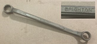

I have no clue on this one. Maker's mark is barely legible in the photo images, but it was originally listed on Ebay as a "Brighton Hi-Test".
Brighton is a city on the southern English coast - that's all I know.
Brighton Hi-Test Chromium Vanadium 5.8 x 11.16 offset double-end box wrench (Ebay 163108271746...jpg

who made this one? and whose private-label brand was "Brighton" ?
Brighton 5.8 x 11.16 Chromium Vanadium DBE wrench (ebay 334258629225 01).jpgBrighton 5.8 x 11.16 Chromium Vanadium DBE wrench (ebay 334258629225 02).jpg
Brighton 5/8" x 11/16" Chromium Vanadium offset double-end box wrench
Looks Barcalo to me. Some contract wrenches marked “Old Forge“.2227A8AF-F853-4A26-9703-D38BDAAFE428.jpeg41DB2AA1-8741-48BE-923F-A3066DB26B1C.jpeg
and some marked Mastercraft.
I imagine if you were buying wrenches from Barcalo on a contract, they would mark them any way you wanted.

C.E. Jennings was one company I found that used Brighton as a mark, but it doesn’t really fit, as it was a saw.
Brighton was in Mass, and there was a New Brighton PA, maybe digging through their directories. But that’s a lot of pain.
13,418
Here’s a potential. Brighton Screw and Mfg of Cincinnati Ohio, was listed as a manufacturer of wrenches in 1940s. I suspect set screw wrenches, but maybe they expanded?
They had Federal Supplier numbers of 71096 and 71099 in 1951, wonder if someone can work that back to a list Of supplies.
Now a portion of Brighton Best International.

^ I'm more inclined to think it's a Barcalo-made private label brand for some retail chain similar to Gambles or any number of others.
There's another "Brighton" wrench up above (post #5) that doesn't look anything at all like the one I just posted above (post #31) for what ever that might indicate. :dunno:

Well, here is a Brighton Hardware in Boston in 1958.
There was also a Brighton Hardware in Cincy in 1873 & 1913, possibly a predecessor to the screw company noted above. But then in 1929, they show up as a chain.
there was a 1957 or 67 reference to a NJ hardware store, some reference to Freehold as well.
and interestingly, Brighton hardware show up in several fictional works as well, just to slow my searches down.
