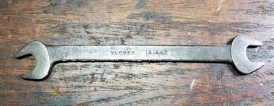

Vlchek made for Caterpillar 1A1442
My 3 versions, the top pair differ by being numbered 6 & 8
Nice line-up. I'm going to assume they're all 9/16" x 9/16", since I have never seen or heard of one being made in any other sizes of configurations. Which is just one of the things that are so strange about these wrenches.
I get Caterpillar wanting to contract with Vlchek. Who wouldn't? If it was good enough for the US Army and Chevrolet and scores of other lesser entities, it was good enough for Cat. But somehow they ended up with a wrench that Vlchek was not known for making. Vlchek wasn't making tappet wrenches with a 22-1/2* angle, they were making them engineers' style (15* x 15*).
I have never seen AA or anyone else wonder about that.
On top of that, they weren't making ANY wrenches of any type with sharp, pear-head jaws. Quite the opposite, they were known for round jaws and some jaws so round they could be called parabolic. The triangular geometry is so extreme, it does the term 'pear' and 'sharp' injustice.
Again, I have never seen AA or anyone else mention that, either.
Why does all that matter? I think it points to the deduction that Caterpillar specified the wrenches.
Think about it. If they had gone to Vlchek to order tappet wrenches, specifying the size (9/16") only, and left the rest to Vlchek's discretion, they probably would've gotten Vlchek's standard tappet, maybe with the same size on each end. Unbidden, undirected, and unspecified, it seems unlikely Vlchek would've had any motivation to suddenly and whimsically decide to diverge from their standard. 'Hey, just for shits and grins, let's throw a 22-1/2* angle on there and sharpen the jaws up.' All of which required new dies!
Blue-Point and Bonney were making the 15* x 22-1/2* asymmetricals. Why not go to them?
I don't know. But I am convinced Caterpillar knew of that style and asked Vlchek to make them.
Again, not discussed on AA or anywhere else I can find.
And I still wonder why they only show up in one size. Did every vintage Cat dozer, crawler, and excavator use valves that had 9/16" hex heads on the tappet and adjuster screw?!

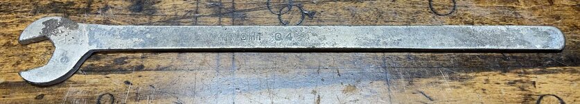

Here is mine. It doesn't have a forge number on the shank, which is unusual.
But the coolest part about it is the marking on the flip side. "S BCAT." I hope we have some Cat cats here who can decipher that into perhaps a vehicle type.

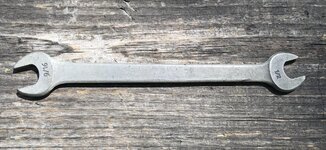

As long as we're on the subject, here is my budding standard 1930's Chro-Moly Vlchek "near-complete set". I have been putting this together onesy-twosy, from in the wild, for quite some time. I would be tickled pink if I could just find one more 94. Two 96's (1" x 15/16") would be gravy on top.
20211019_114437.jpg20211019_110701.jpg20211019_114446.jpg20211019_114452.jpg20211019_114723.jpg20211019_110701.jpgVlchek tappets.jpg

Here's a wrench I can't positively identify. The COO marking and the model number smack of Vlchek, the heads kind of look like Vlchek, and I keep it with my Vlcheks, but they always had a taller "C and "M" in their all-caps "CHOME-MOLYBDENUM" marking. Always. And not just on their tappet wrenches. On all wrenches. It was their signature thing.
20211018_093243.jpg20211018_093308.jpg20211018_093247.jpg20211018_093251.jpg20211018_093301.jpg20211019_114723.jpg

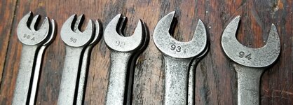

Here are some of mine, including one with the fun head shape. The # 89 blatantly breaks the big C-M rule.

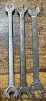

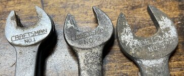

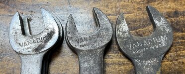

I’ve also got a handful of -V- series craftsman tappets.
The smallest has no number and is 3/8 & 7/16, next is the #44471 which is 7/16 & 17/32, followed by #44472 which is 1/2 & 9/16, followed by No.3 (5/8 & 11/16) and No.4 (3/4 & 7/8).

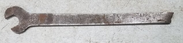

Since this wrench self-identifies as a tappet wrench, I'll post it here. It appears to be punched out of 5/32" steel sheet and the opening measures 9/16". It appear to have been caught up in something and left its "tail" behind. I got it in a bunch of stuff last week.
P
30,913
I have a thing for eponymous tools, Jock. That's a neat one. Clearly very early.

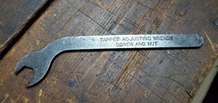

I wish I knew who made the 'TAPPET ADJUSTING WRENCH SCREW AND NUT' I circled in post #1. And I'd like to find another one, too.
Here it is again by itself.
