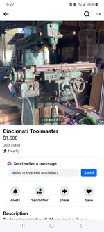

I've read a little about these on PM, better built over the BP but more expensive etc. Anyone running one? I see one on FB MP.
I have ran one, very nice and heavy machines.
Much better than a series 1 Bridgeport and I would even rate them slightly above a series 2 Bridgeport.
Closer to a Tree in quality.
I want one someday.

From what I remember collets on them are unique although later machines came with a 40 taper spindle. So make sure you buy a machine that has a full set of collets or a 40 taper spindle.

The one I used had a NMTB 40 taper which are available. Your absolutely correct about the odd size collets some mills used such as the B&S collet as the are hard to impossible to source now days

I've only run one or two but enjoyed using them more than a BP. More robust, smoother, less vibration (mass) and just a better build IIRC. The post above saying get a full set of collets is spot on, find out what the spindle taper is before negotiating price.
Photos will be required if you get it.

Already sold.
-As was once remarked to me by a realtor (but applies to cars, machinery, apartments, etc.) "If it's priced right and shows well it will sell quickly". There are always people that only look for what's a cut above the rest, the Cincinnati (if it was in good shape) was a highly sought machine and didn't last long on the market. Sorry you missed that chance, I'd like to have one too. You'll now know to beat feet to a seller with cash in hand if it's something worth buying. What was the seller asking?

It was the one above, to far away without any contact from the seller.
