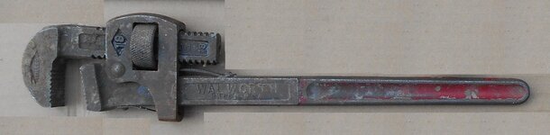

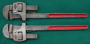

I originally thought this abused and neglected old pipe wrench was going to be a complete waste of time:
My "Evaporust" turned black a few months ago, and it's starting to get thick, so I let this thing soak for about a week before I pulled it out.
I went at it with a pad of #3 steel wool, but that wasn't doing what I wanted, so I dug out a soft brass-bristled scrub brush and went at it with boiling hot water, trisodium phosphate, and Simple Green. I spent maybe half an hour scrubbing it to get it cleaned up, dried it in the oven, and applied a coat of BLO.
Walworth Mfg. Co., Boston, Massachusetts 18-inch "Stillson" pipe wrench

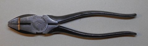

In response to an issue raised in a now-revived zombie thread concerning stiff pivots on pliers:
I picked up this pair of Diamond linemans pliers back in November, along with some other oddballs I found out in the yard over at Earthwise - items which had been left out in the rain. These were rusted solid when I got them (as well as the small diagonal cutters just above.)
When I say "rusted solid", I mean that I was not able to open them using both hands:
Diamond SL58 9 inch linemans pliers 11/12/25
Using a soft-bristled brass brush and a can of WD-40, I got them cleaned up and loosened up enough to open them part way, but not fully opened.
Then I grabbed my tiny little oiler can and flooded the business end with Marvel Mystery Oil, then grabbed the handles and started working them open-close-open-close-open-close-open-close-open-close-open-close as fast as I could until they started to loosen up.
Flooded them again, and repeated the process several times.
Now I can grab one handle, wag them up and down, and the joint is loose enough they just flippity-flop open and close.

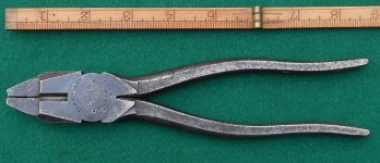

It worked so well, that I didn't hesitate when I found this pair of Crescent 9-inch linemans pliers a couple weeks ago, also rusted solid:
Crescent Tool Co. 1950 9-inch linemans pliers (prior to cleaning) 01/08/26
These got the same treatment: brass brush and WD-40, then the MMO and lots of open-close-open-close until they loosened up.
A few days later I acquired a brass wire wheel for my little grinder, so I figured I'd try it out with both pairs of linemans pliers.
They came out looking pretty snazzy:
Crescent Tool Co. 1950 9 inch linemans pliers 01/27/26
You will note in the last couple photos several other pairs of pliers, most of which were in similar condition - they all got pretty much the same treatment, but just to experiment, I used "3 in 1" oil instead of the MMO. Worked just dandy.

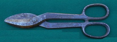

Wiss model A9 12½ inch Straight Pattern Snips 06/02/26
After a week in the Evaporust bath, wire wheel, and some nice "Harbor Blue" enamel (and a bit of BLO on the business end)...
Wiss A9 12.5 in straight pattern snips 061526 01.jpgWiss A9 12.5 in straight pattern snips 061526 02.jpg
Wiss model A9 12½ inch Straight Pattern Snips 06/15/26
These will be going to my buddy, as he's informed me he does not own a pair of metal snips. :rolleyes:

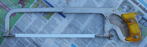

This lovely piece had suffered from neglect and improper storage:
Craftsman 9AC3558 "Master Grip" hacksaw - as found - 06/20/26
The "collector appeal" on this unit is in that fancy yellow handle, so I wanted to be sure to not damage it in any way.
Removing the scales was a challenge, as both screws were rusted tight. Soaking in Kroil overnight got one loose enough to remove, but the other one just wanted to spin around and around. After several attempts, I laid that smooth convex-head button headed screw on a rubber "jar lid remover" sheet - just a thin sheet of rubber with a grippy surface - and managed to get that second one out - not, of course, without stupidly buggering up the slot on the head of the screw.
With the scales removed, I dropped the frame into the Evaporust overnight and let it soak.
The piece had been subject to wanton neglect and was tossed around in somebody's box, causing that pretty yellow handle to get all scratched up and faded.
Meguiar's introduced a line of "plastic" products in the early 1980s. There were about 7 different SKU's. We brought in two of them: a "cleaner" and a "polish". I still have a bottle of the cleaner. Not sure where the polish went. The product was made just for this sort of thing. Don't know if they still make it:
Craftsman 9AC3558 "Master Grip" hacksaw scales after cleaning with Meguiar's Plastic Cleaner
This was close, but not what I was hoping for, so we went old school:
Craftsman 9AC3558 "Master Grip" hacksaw scales after buffing with toothpaste
Not sure if any of you fabricated the clear plexiglas "Letter Opener" in junior high shop class. (My class didn't make them, but others did.)
The boys would sit in class with a rag and a tube of "Crest" and buff those things until they were crystal clear.
It has to be one of the "old" brands that still contain a tiny bit of chalk powder - just use a piece of terry cloth and go at it.
1939 Craftsman catalog pp 27 - hacksaws
You'll note in the catalog description that this unit was produced with a polished nickel-plated frame. That being the case, the last thing we'd want to do would be to scratch up that nice finish with steel wool or - God forbid - putting it on the dreaded wheel, as was the case with this unfortunate victim of abuse:

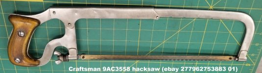

Craftsman 9AC3558 hacksaw (ebay 277962753883)
Aside from the crazy asking price (of $100.00), I would posit the reason this piece still hasn't sold - notwithstanding its rarity - is that the seller has compromised its intrinsic value by putting it on a wire wheel - something I consider "last resort" stuff (although I've found myself doing quite a bit of it lately with horribly rusted items.)
But I digress....
Still chanting my mantras of "Do No Harm" and "It's only original once", it was time to pull the frame out of the pickle pot and see what it looked like. There were still some splotchy areas and some tiny dark spots here and there, so I dug out Mom's favorite:
Craftsman 9AC3558 "Master Grip" hacksaw - Wright's Silver Cream for the win! (y)
