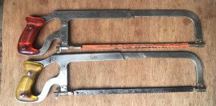

Well... it's not marked with the "Long C" on the tool itself, but it does appear that way in the catalog illustration:
1939 Craftsman catalog pp 27 - hacksaws
This beauty was apparently manufactured between 1939 and 1942, and sports a production code of "BB". While not cited in Lauver's list, it looks like the likely culprit would have been Stanley. GJ member @d42jeep's photos of the same Craftsman "Master Grip" side by side with a Millers Falls specimen makes it look like the original maker was Millers Falls, not Stanley.

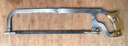

This was not in the best condition when I found it, and required a bit of sprucing up:
Craftsman 9AC3558 "Master Grip" hacksaw
photos and description of restoration HERE
That’s a good find! It should hopefully do well on the bay!
28,925
^ We're going to find out.
It's a nice saw, but that old Lenox I found is a much better design and far more fun to use.
I was actually kind of surprised by the heft of this Craftsman unit - it is not your usual "lightweight adjustable frame".
13,169
So.... it was Millers Falls who made that, eh? NOT Stanley, as one might assume from Lauver's list.

I just added: BB Also found on Millers Falls made Amber handle hack saw - Long C period?
Are we certain its MF for these saws?
I list MF as:
F-circle = Millers Falls
28,925
^ I think that Don's example clinches it as far as this unit goes. I just revised all my posts on this and the ebay listing as well.
I can't see how one could argue that it was NOT made by Millers Falls:
Gary Lauver's list shows "BB" as "Stanley", but only a few select items (slotted screwdrivers and a plane, but not Phillips)(how weird is that?) :headscrat
So you have to ask: why would Millers Falls need to outsource a saw? They were a primary supplier - they sold all kinds of stuff to Sears.
In my mind, it just does not logically follow that MF would outsource a saw from Stanley.

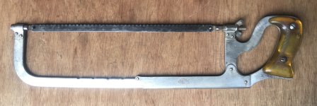

It seems like Millers Falls is likely to have started making those hacksaws around 1938 since they are marked “new”. Besides the upscale No. 84 they offered a less expensive No. 48 with the handles less fancy and riveted in place They offered both styles for a long time.IMG_0821.jpegIMG_0820.jpeg
28,925
I'd say that pretty much clinches it, no? :unsure:
Shape of scales on the MF model 84 is same/same as the Craftsman "Master Grip"
Cut-out hole at rear of handle is same shape on both the MF 84 and MF 48 as on the Craftsman "Master Grip".
Thickness of frame at rear is 3/16"
Only difference I am seeing is that Millers Falls isn't touting that fancy-schmantzy "polished nickel plated frame"
(Sears had better pitch men, obviously. ;) )
