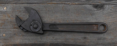

29,523
Hedstrom Industries Larc-O-Matic Wrench (patent 1830033 2351821)
cleaned up with WD40, brass brush, #2 steel wool, and MMO.
