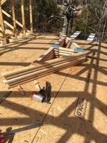

I hand built trusses for the cupola. They can just be handed up.

At this stage we had a wind storm.
Just before dark the wind was 30 mph out of the south and the cupola was leaning. I shouted at Shane and scrambled up with a ratchet strap and got it stabilized. He arrived soon after and we got the one he brought up. with two straps on it we were able to jack it back plumb. In retrospect it was a risk not worth taking but we got lucky. No more wind forecast but we got sheathing on it in a few days.
The kind lady threw a fit when I started to put roofing steel on. I hired a local guy and his dad and they got started.
She was being unreasonable, the purlins make a ladder but I compromised. I carried the metal and stacked it on the scaffold for them.
Plumbers had their work cut out for them. Second floor bathroom had minimal fall through the floor of the attic trusses, the toilet and shower are on the far side and the tub joins close.
