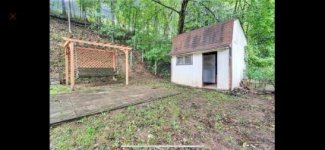

Spent the last week working in the property. I got the entire first floor repainted, fixed a few small issues and then turned my attention to the outside.
The shed that was there is removed, same as the gazebo, and the stone patio. I’ll bring in a skid steer today and get to leveling for the shop. I’m thankful that some of my dearest friends will be over today to throw some boxes in pickup trucks at the apartment and drive them over to the house. Pics to follow!!!
