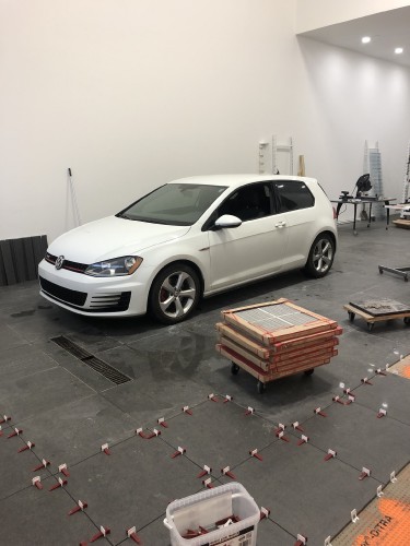

I took the plunge and started doing (Porcelain tiles) to my 1,200 sqft this summer. And thanks Dakato00 for inspiring me (PM'ed him way back 5-6 years ago, but still nervous to do it)
Anyway, I spent the money on Ditra, there're a few other companies like Mapei (big thinset maker) that has their own uncoupling membrane, and many generic imitation out there too. But it was $1.60 Cdn/sqft when I buy the big rolls and a local flooring store will sell per sqft $1.75 Cdn/sqft at the end of my Ditra space.
I just love these recent years of large format tiles 24x24, ***** for a novice (first time) like me, but oh well, just took that plunge.
I used Perfect Level Master brand for wedge system 1/8" spacer/leveler. 300 pieces of 24x24, and I'm at around 275 pieces installed, every single piece I back butter (I used a round office chair stool as my tile spinner). However, reading up many tiling YouTube and forums. I think a better mindset over back butter is also call "Coverage", for me, in order to achieve this, is to dry test before laying thinset on the ground (for areas I may think isn't super flat, so visually I know which areas will need more thinset splattered onto), and of course, like the videos, is to audit your technique once in a while by completely lifting and checking the back of the tile; super pain in the *** for 24x24, of course commenting as a DIY newbie here only. And to wiggle to collapse those toweled rips.
How long will mine last? lol I guess we'll have to wait it out. Not going to heavy wrench in there though, just vehicles, tool cart, foot traffic.
In terms of the wedges, correct, the base part of the wedge product remains. However, based on watching videos of wedge systems (in general), the wedge base is suppose to be EMBEDDED within the thinset, so it hardens as a singular piece.
Whether a few pieces will crack or chip, I do have to say, just love team Porcelain (i.e. in your own garage, as if you're inside a car dealership). On top of that, as much as 24x24 is killing me. I can't go to 12x24 for my next garage flooring project. (I might however, just pay a professional doing 24x48; of course that's if they'll recommend that large for automotive related, but definitely 24x24 if I can)
