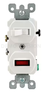

We have a closet where the door fits so tightly you can't tell if the light is on when the door is closed. I want a switch that shows when the light is on. Having one that is lit when off would mean that we would have to remember to notice something that is missing.
What type of switch do I need?
BillK
Aug 24, 2006
9,403
Beautiful Southern Maryland
The problem with lighted switches is that they usually need a neutral. Most switch runs just break the hot wire going to the light. You need to pull the switch that you have now and look to see how it is wired and if there is a neutral in the box.

OP could also do a timer or occupancy/motion bulb or switch.
That red indicator would look too out of place for me
From what I just watched on line, a code change in 2010 required a neutral in the switch box. I house was built in 2008, but our electrician seems to have run power to the switch box and then to the light. I checked and I'm good to go.

For a simple closet light switch in a bedroom, can you just look and see if it is on or off? We used indicator light switches for attics, etc, back in the 80's and prior. With all due respect, up is on, down is off. For a simple closet light....
rawen2
Feb 26, 2021
170
High Desert of CO
If it's a standard toggle style switch you could color the bottom side of the toggle with red sharpie or nail polish. It will be visible when the switch is up and be hidden when the switch is down. Won't work as well with a decora style switch although you could color the thin side edges of the toggle.
