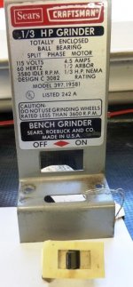

The Craftsman vintage grinders with Block-style-motors have a number of different switch styles, depending upon HP and year of manufacture.
For broken switches with plastic bodies and toggles like the one below, I have adapted a switch with a metal toggle.
Link to restore --> http://tinyurl.com/CM-0-75HP-397-19350-Berry
While the above fix works very well, it does take some time, material, and effort.
I want something that is a 'snap-in' solution.
I found that 3 power switches to some Bunn coffee makers will work.
The test dummies:
Left - flat-top 1/2-HP m-397.19441 with a red/black power switch,
Right - round-top 1/3-HP m-397-19581 with a black/*********** switch.
The power switch (PSW) cut-out details.
Slight narrowing in the center.
Continued on post #22, below.

Thought I would post my block switch replacement. I had to file my switch opening to about 13/16" x 1 7/16" and it fits and works fine. The switch is a Carling Blodgett 1429R I bought off Ebay for about $12. It can be had for less if you like a blue rocker. It's marked as being good for 3/4hp or 20 amp 250V. It has a nice positive "snap" when it switches. I think it has a nice "vintage" look as installed.

Evaluation - None of the 3 power switches are an exact fit; they are (~1/8") narrower than the tested flat top and round top Block grinders.
With the PSW centered in the cut-out, there is no evident gap.
Each PSW was cycled ON/OFF at least 25 times. All of the PSWs have a firm and positive action. The spring clips that hold the PSW in the cut-out, keep the PSW held in place while cycled ON/OFF 25+ times.
To permanently mount the PSW, use 3-4 dabs of epoxy at the back of the PSW/cut-out interface.
Recommendations
Any of the 3 switches are suitable as 'snap-in' replacements for up to and including 1/2-HP Blocks.
You may want to use 3-4 dabs of epoxy to keep the PSW centered.
Best-Buy
1/4" Spade Terminals
1442 R | BU04225.0002
Editor's-Choice
Screw Terminals
1514 R | BU01186.0000
I like the feel of the switch, it was a bit more positive. Additionally, the screw-on terminals are my preferred motor electrical-connector.
Thanks for looking. :)

You can use Single Pole Single Throw switch above on a Dual Voltage grinder wired up for 115V, but the grinder cannot be used/wired for 230V.
I have several schematics/diagrams of Block wiring. If you post the model number, I will be able to choose the appropriate one.
