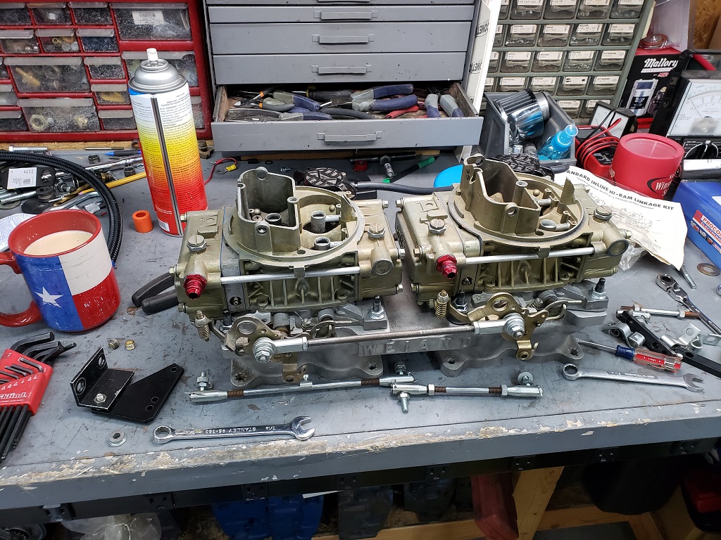

Falcon67
Jun 11, 2009
18,371
Merkel, TX
So, "if" you were to put a coat on your hardwood bench top, which do you think would hold up to everyday use, without having too worry about it?
Part of me says a few coats of Poly. But the ideas of using oil has me intrigued!
I used regular garage/porch/floor paint from Lowes. Had it mixed to a gray color, just a tint I liked. The bench is going on 9 years in use with cylinder head work, carb rebuilds, wood work, misc stuff. Nothing much "nice". It's seen plenty of Berrymans, pump fuel, race fuel, methanol alcohol and all kinds of stuff spilled on it. Haven't had to repaint it yet. It looks used for sure, but not nasty.
90% of bench work takes place here. Some of the top would look new, if you could move all the junk off those places LOL.
