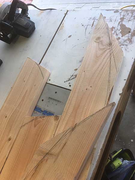

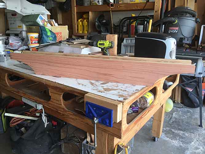

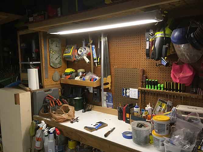

varnish or wax, or just put a new 1/8" thin skin on a little more often.
I've gone with melonite/melamine / coated particle board for my bench surfaces. East to work on, slightly slick, pretty resistant but you can't leave solvents on it forever. Thin I like the most is that it's easy to write notes on and relatively easy to clean them off after a project is done.
Only drawback of it is if you gouge the coating you'll get a lot of swelling in the particle board if solvents get to it later.
