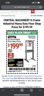

Side note, my want of a shop press keeps me watching and I saw this Black Friday sale for the 20 ton press at harbor freight. I might be picking one up.
I literally just succumbed to the temptation and got one of those even though I have no immediate need. Already found a use I didn't expect for it and glad I have it.
Put an alert on the air bottle jack for hfpricetracker.com now to upgrade.
Probably going to steal a couple of these ideas as well https://www.garagejournal.com/forum/threads/harbor-freight-20-ton-hydraulic-press-upgrades.501515/
I picked one up also, but it still resides in its box.
I do want to add locking caster wheels so I can move it easily!
