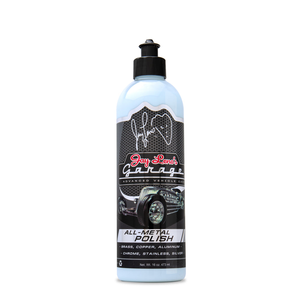

If there is no coating on the bright parts of the wheel. Hit them with a buffer wheel/compound on a drill. That's how I did the wheels on the Suburban after I removed the clearcoat.
madison069
Nov 5, 2010
4,480
Monroeville, PA
I will say, the bare aluminum trim area is really rough from the sandblasting. I fear I will have to do some sanding first to get it smooth down. Should be a good winter project. Just need to secure the supply.

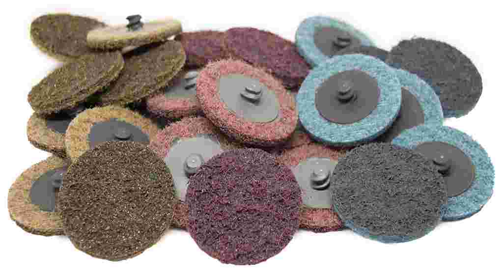

Cody, my go-to place for metal polishing is Benchmark Abrasives. For small areas like the spoke faces on your rims, I use their Roloc discs in either 2- or 3-inch sizes. If the surface is deeply pitted I use surface conditioning discs first, from coarse to fine.
There's even finer gray surface conditioning discs but best not go there.
If it's just a dulled or oxidized surface I use wet sanding paper on a block of wood starting with the finest grit that gets the surface even (400) and going as far up the scale as needed to minimize the buffing time (2500 or 3000 grit).

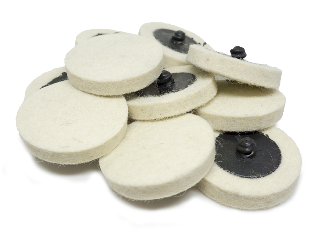

For the buffing, I start with felt discs and white compound. Works especially well on that flat part of the rim edge.
For the final step I usually put a little Mothers Magnesium & Aluminum polish on a fresh felt disc. I recently tried Jay Leno's All Metal Polish for S&Gs and it works great on all kinds of metal but at around four times the price of the Mothers paste, it's hard to justify. I mostly wanted to try Leno's product on some stainless steel and it worked great.
See, I figured out how to spend almost sixty of your dollars without hardly trying. My bad.:confused:
