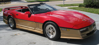

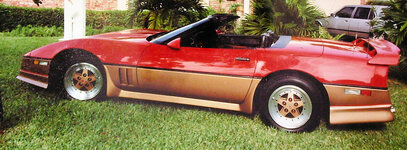

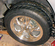

Cody, I know what you are going through. I bought my '87 Corvette in December 1991. It had a bunch of aftermarket stuff on it, including 16" rims. The spokes were professionally sprayed gold to match the body but the emblems were painted with a brush. I liked ground effects packages on these C4s but mine was a kluge with rockers that didn't go with the front and rear. The convertible top appeared to be tan but turned out to be a poorly dyed white top. The leather seats appeared to be 40 years old so I re-did the seats and put a new tan vinyl convertible top on the car. That was my first convertible top install and unless I have a complete loss of memory it was my last. A smoke show resulted in all new audio equipment and a few hundred yards of new 'wire nut free' wiring. At some point I dinged the front air dam and planned to repair it. It didn't look bad from the outside but when I looked underneath to assess the damage, it looked like a fiberglass quilting bee had been there before me. I went on a hunt for a replacement front ground effects panel. Found it and the matching rocker/door set and waited. This is the car, as purchased, in 1991. What I thought was a gem had some hidden flaws, including re-capped Goodyear Gatorback tires! The weights on the rim should have given it away. :mad:
In 2007 I had the car re-painted after I acquired a new front air dam and matching rocker panels. Before it went to the body shop I removed the reflective red tape from the front and rear panels. The tape was hiding latex caulk that was used to fill some gaps and was showing through the paint. That led to me the next logical step, remove the rear spoiler, rear ground effects panel and the whole rear bumper (it starts at the rear wheel arch). A heat gun and a bunch of sharp implements removed a total of a pound of caulking, 14 coats of paint from the bumper and 9 coats from the ground effects panel. I discovered the gold paint on the wheels was not original and the clearcoat on them was turning milky. By 2012 it bothered me enough to use Klean-Strip KS-3 Stripper to remove both clear and gold paint. The Stripper also removed the black paint from the phony socket head screws (it's a 1-piece aluminum wheel). At least the rims weren't sandblasted and it turned out they were gold anodized before machining the faces. Took more than a minute to get the set to shine.
It's no show car but I'm no longer embarrassed to drive it to a show.

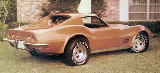

Cody, I've been working on the '72 Corvette for so long, It's on its third set of rims. When I bought the car it had Ansen style rims with wider rims in the rear and spacers to make it extra stupid looking but it was 1978 so I wasn't alone and the 454 automatic coupe cost me $4,200. First thing I did was buy new tires and remove the spacers from the rear. The bolts on the transverse leaf spring were also adjusted to be as short as possible so I returned them to the stock length. Tires still stick out but being 50-series I could drop the ride height to something more normal.

Those tires held the car up for a couple of decades, the first of which IBM punished me with a 'promotion' to middle management and I had zero time to work on the car. When we returned to the US from Australia in 1991, Liane ordered me to buy another Corvette and get rid of the Fiat X1/9. Enter the '87 Corvette. In 2008 I was ready to put paint on the '72 but the Unilug rims and 25-year old tires were scaring me. Sold the whole set for $100 and the guy who showed up wanted to haggle. He said $80 and I said $200. He said $90 and I said $400 (that's what I paid JC Whitney for them) and he somehow found the $20 bill he told me wasn't in his wallet.
Another reason I got rid of those rims was their size. By 2008 there were very few 16-inch tire choices and none were good. An eBay listing for a set of four polished aluminum 17-inch 5-spoke Torque Thrust knockoffs specifically designed to fit C3 Corvettes caught my eye. For $1,100 they came with Federal tires, 225/55-ZR17 for the front pair and 255/50-R17 for the rear. Interestingly those tires are real close to the same diameter

I dig those rims you got off eBay.
I know I can get a set of 15” tires and spend $600 instead of buying new rims and tires which can equal to $1,400-$1,600 and get the 17” I want in the end. Unfortunately I got a lot of projects going on and one big one is sucking my money dry. But, I’d like to be able to drive the Camaro around town so I can get used to it and find the bugs in it. Plus, it’s been a project that has taken too long. It will be 27 years since I first got this camaro and I never really driven it much.
