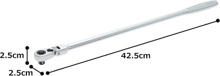

While torquing the head bolts of the mower, I started questioning my torque wrenches. My little 3/8" drive torque wrench seems to be working properly, but the bigger 1/2" drive torque wrench didn't seem to be working right. The 3/8" drive went up to 25 ft/lbs fine, but trying to get the next torque sequence of 40 ft/lbs I just didn't trust the feel of the bigger one. the smaller 1/2" drive seems to be working correctly at the lower setting, but I just don't know. I think I will be getting new torque wrenches since these have to be over 20 years old. Been trying to decide what brand i want to gamble on next.
Any suggestions?

Both 3/8s for me got the 40/200 straight head and the 5/75 flex. I had an old craftsman dial indicator that kve used since I was in my 20's.....
I didnt the 2nd one was a flex head till I got home hahah. It doesn't flex much? Unless its got ratchets i didnt push hard enough it only moves about 20 degrees?
I like them plus the straight one was super on sale when I picked it up

My new 3/8” flex head tone ratchet came in the mail. It’s not as small as the little tone ratchet I have, but it’s smaller than my other 3/8” ratchet of similar size.

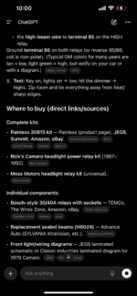

https://ceautoelectricsupply.com/headlight-relay-kits/h4-sealed-beam-headlight-relay-kits/
The relayed harness I built for my Z28 had all the big components from CE Auto. The harness in the Suburban is also from CE.
That’s a pretty good price for a ready to go wiring harness!
The ChatGPT results got me to thinking though. I wonder if it would help layout wiring for the garage more efficiently and lighting results?
Gonna have to play with it some more. But it’s cool how it does the thinking for you, it also ***** cause it does the thinking for you so your brain processing could become slower. Don’t use it, you lose it, kind of thought.
